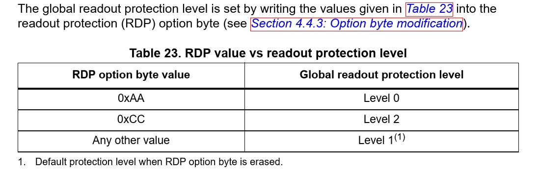

Setting the RDP (Read protection) to 0xCC means you have activated the RDP Level 2:

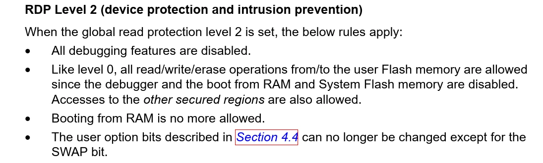

  • When the global read protection level 2 is set, the below rules apply:
  • All debugging features are disabled.

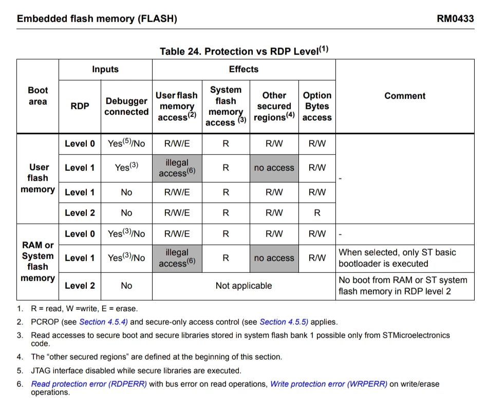

  • Like level 0, all read/write/erase operations from/to the user flash memory are allowed since the debugger and the boot from RAM and System flash memory are disabled. Accesses to the other secured regions are also allowed.
  • Booting from RAM is no more allowed.
  • The user option bits described in Section 4.4 can no longer be changed except for the SWAP bit.

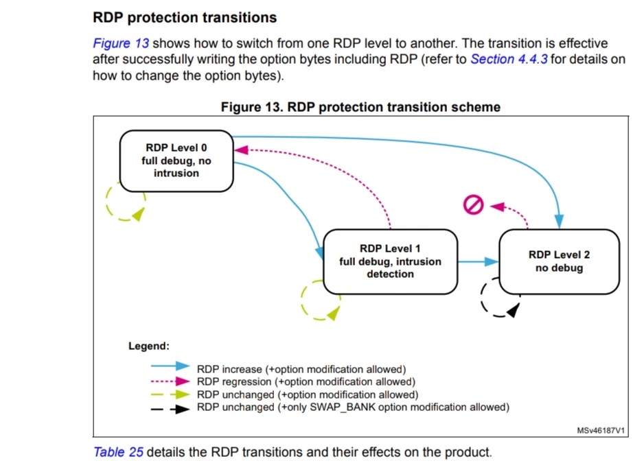

  • Caution: Memory read protection level 2 is an irreversible operation. When level 2 is activated, the level of protection cannot be changed back to level 0 or level 1.
  • Note: The JTAG port is permanently disabled when level 2 is active (acting as a JTAG fuse). As a consequence, STMicroelectronics is not able to perform analysis on defective parts on which the level 2 protection has been set.Apply a power-on reset if the global read protection level 2 is set while the debugger is still connected. (According to the part 4.5.3 of the RM0433).
Then is going to be impossible to reduce the protection level.
That's why you need a new board now since this board is locked.
