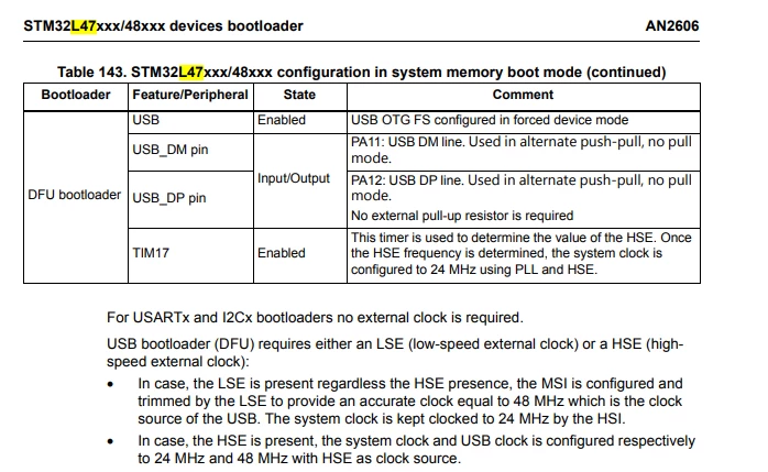

Hello @SLinux​ and welcome to the Community :)
It would better to share the screenshot of your configuration and the message error, in order to help you.
I advise you to refer to AN2606 related to STM32L47xxx devices bootloader and check the needed configuration.
