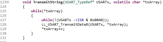

But now I want to transmit a string:
TransmitString function:
And the problem is that string is transmtited only one time when first time data = 'A' is received. When data = 'A' is received again, nothing is transmitted. Could you help me to solve this problem?

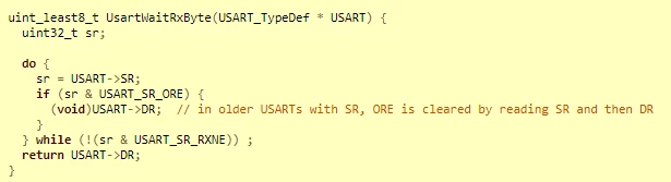

waclawek.jan
May 18, 2021 5:24 AM UTC
Which STM32?
Maybe receiver stops working due to unhandled overrun error?
Indois
IndoisAuthor
May 18, 2021 1:12 PM UTC
I use STM32L011. I will try to check if this code of overrun error correction helps. Thank you.
Indois
IndoisAuthor
May 19, 2021 12:30 AM UTC
How should I use this function?
It blocks receiving data if I start it in while, before data=LL_USART_ReceiveData8(USART2).
