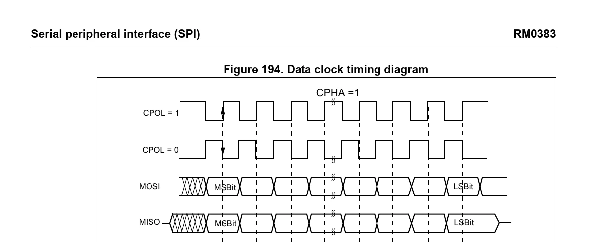

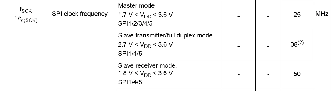

AScha.3
May 23, 2024 9:40 AM UTC
Read in rm of your cpu, what SPI can do:
So if you know the format (like 8bit words, clocked at rising clock) you could set the SPI to slave mode (= just "listen") and get the bytes clocked in at up to 50Mbit :

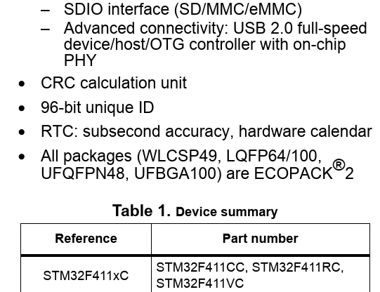

AScha.3
May 23, 2024 11:20 AM UTC
@LCE  , he has a F411 : with SDIO...
So its more "just playing around" . :)
