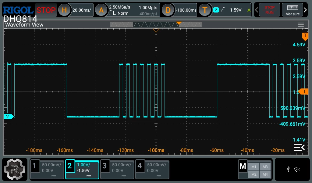

I'm working on a project wherein I'm trying to play an audio file in reverse. I'm using freeRTOS, fatFS, and a 4-wire SDIO setup, and am doing this little file read dance where I:
  1. f_lseek() to the end of a file
  2. calculate how many bytes I want to read
  3. f_lseek() backwards
  4. do the read()
  5. goto 2
Then, later, I reverse my audio samples.
I'm experiencing some odd behavior that I don't understand, however. To try to wrap my head around it, I toggle a GPIO each time I start the above cycle. I would expect - when probing this GPIO with a scope - to see a reasonably constant square wave period that would help me understand how long the whole operation takes.
What I see, however, is something different: I see a few high/low cycles, then a period of what looks like inactivity, then another section of high/low cycles:
I'm still coming up to speed with my understanding of fatFS, but I'm curious what might cause these 'pauses'?
I understand that what I'm doing - constantly seeking backwards in a rather large (47MB) file is ill-advised: I think what I'm doing is constantly traversing a tree from the beginning each time I do this seek (?). But it's not clear to me why this might take dramatically longer for some cycles and not others.
I've also got some browser tabs open here trying to understand what other options I might consider for this (e.g. I wonder if a different filesystem might be more suited to this task? LittleFS?). But rather than just chalking this up to "this doesn't work", I'd like to understand more deeply what I'm experiencing.
Thanks for any insight anyone may offer!

Need to be reading substantively large blocks, whose physical alignment (start) is aligned to cluster or sector boundaries.
Can't you use f_size() to determine length of files, just from the directory structure without traversing the FAT?
http://elm-chan.org/fsw/ff/doc/size.html
Caching of file system structures, could also help.
Oh interesting; are you saying the non-uniformity of these reads is because I might not be landing exactly on a read spot that's aligned with a cluster or sector boundary? I'm doing no work to enforce things to do that; that's a helpful clue.
Oh yes, absolutely, good point, Though, I don't seek to the end of the file iteratively, so I don't think that's impacting my overall performance here. But good optimization note, thank you!
Can I trouble you to elaborate on this a bit? I'm not fluent enough yet to understand this, sorry.
I'm curious if it's also the case that you'd advise exploring other filesystems; might there be some that are more suited to this task?

The FAT Tables can be quite large, depends on the capacity, and the cluster size, and whether the file was written in a linear way. Most file systems are not optimized toward reading files backward.
Optimization here might have more to do with how much memory you can commit to the task, whether you can manage the backwardness via memory access instead of file access, or swapping in-situ.
There's probably ways of optimizing the representation of FAT cluster chain, within the file system's specific implementation, I'm not sure FATFS does that optimal, or do any caching beyond a sector or two.
