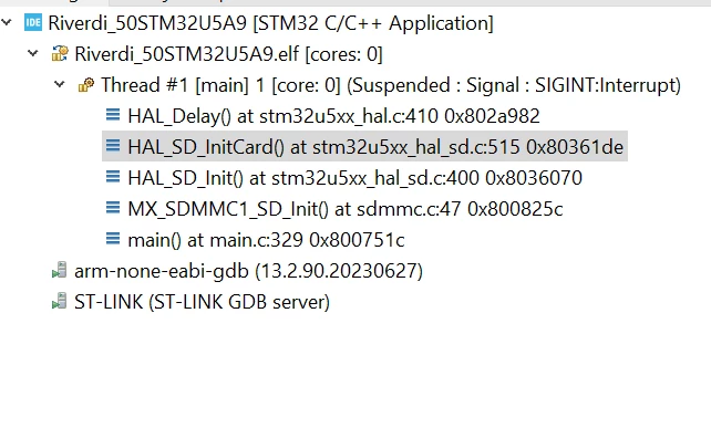

I have been trying to read/write into an SD card using the SPI or SDMMC method with Fatfs. I wasn't able to make use of the filex option for file operation which is provided in the STM32u5A9 libraries, since I am using FreeRTOS in my project (as per notes, Filex cannot be used with FreeRTOS). So, I have taken the FatFs library from STM32F4 design and ported the same to STM32U5A9 design (took reference from https://deepbluembedded.com/stm32-sd-card-spi-fatfs-tutorial-examples/). Unfortunately, in both SPI and SDMMC methods, I was not able to initialize my SD card and the application keep on waiting for SPI Rx data in SPI mode, and in SDMMC method, the application keeps on waiting in a HAL_Delay() in HAL_SD_initcard() API
Is there any known issues in this board type? Can you point any working examples for STM32U5A9 with FatFs and FreeRTOS?

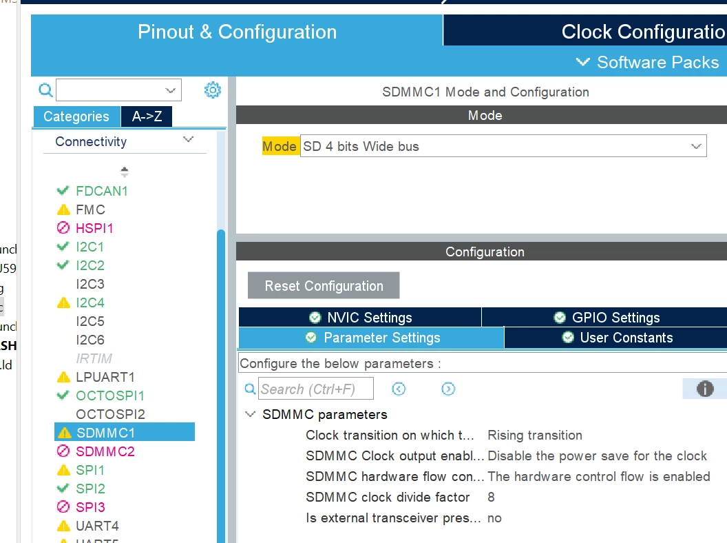

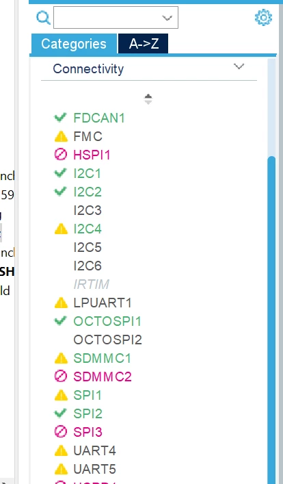

Aug 20, 2024 5:15 AM UTC
I don't see SDIO option in my ioc file. I assume I can use only SPI or SDMMC (may be SDIO inbuilt) to access the SD card.
Just further information about my setup. I am using a RVT50HQSFWN00 River DI 5 inch display module which already has an SD card slot available onboard. So there are no physical connection that I have added additionally. Since it already had the SD card slot, I have enabled the SDMMC1 in the ioc and built my application. The clock device factor was set as 0, 8, 128 (tried all three settings), but the SDMMC init function "MX_SDMMC1_SD_Init()" was keep on waiting in a HAL_Delay() when I tried to debug the app.
Can you share some insights on what's wrong here?

Given that the SD card slot is integrated into the display module and you are using the SDMMC1 interface, could you please try to verify that the clock configuration for the SDMMC1 peripheral is correct? This could be a potential reason for your issue because the SDMMC clock should be derived from a stable clock source, typically the PLL or HCLK. It is advisable to meticulously review the clock tree in STM32CubeMX to confirm that the SDMMC1 clock is properly configured.

Aug 26, 2024 6:53 AM UTC

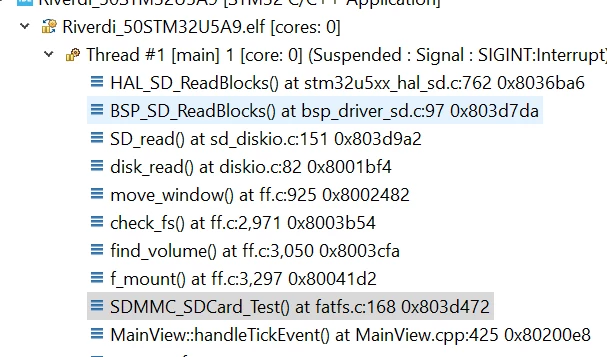

I have crosschecked my clock configuration and made sure the pre-scalar values are set correctly. The SDMMC1 init function was not initialized properly, so I had to rebuild the ioc. Once after that rebuild and few timer changes, my SDMMC init worked and I was able to read/write into SD card, but only before the FreeRTOS tasks start, as soon as I start the FreeRTOS tasks, my SD card read/write operation waits in HAL_SD_ReadBlocks() indefinitely, so I am confused here. Why was I able to access SD before the FreeRTOS task and not after, can you please shed some light here?
My main function looks like this: (the SD read write API calls before  "/* USER CODE END 2 */" works fine, but not after FreeRTOS init)

In one of the FreeRTOS task, I am calling the SDMMC_SDCard_Test() API again, which doesnt proceed further from
HAL_SD_ReadBlocks() API's HAL_Delay.
