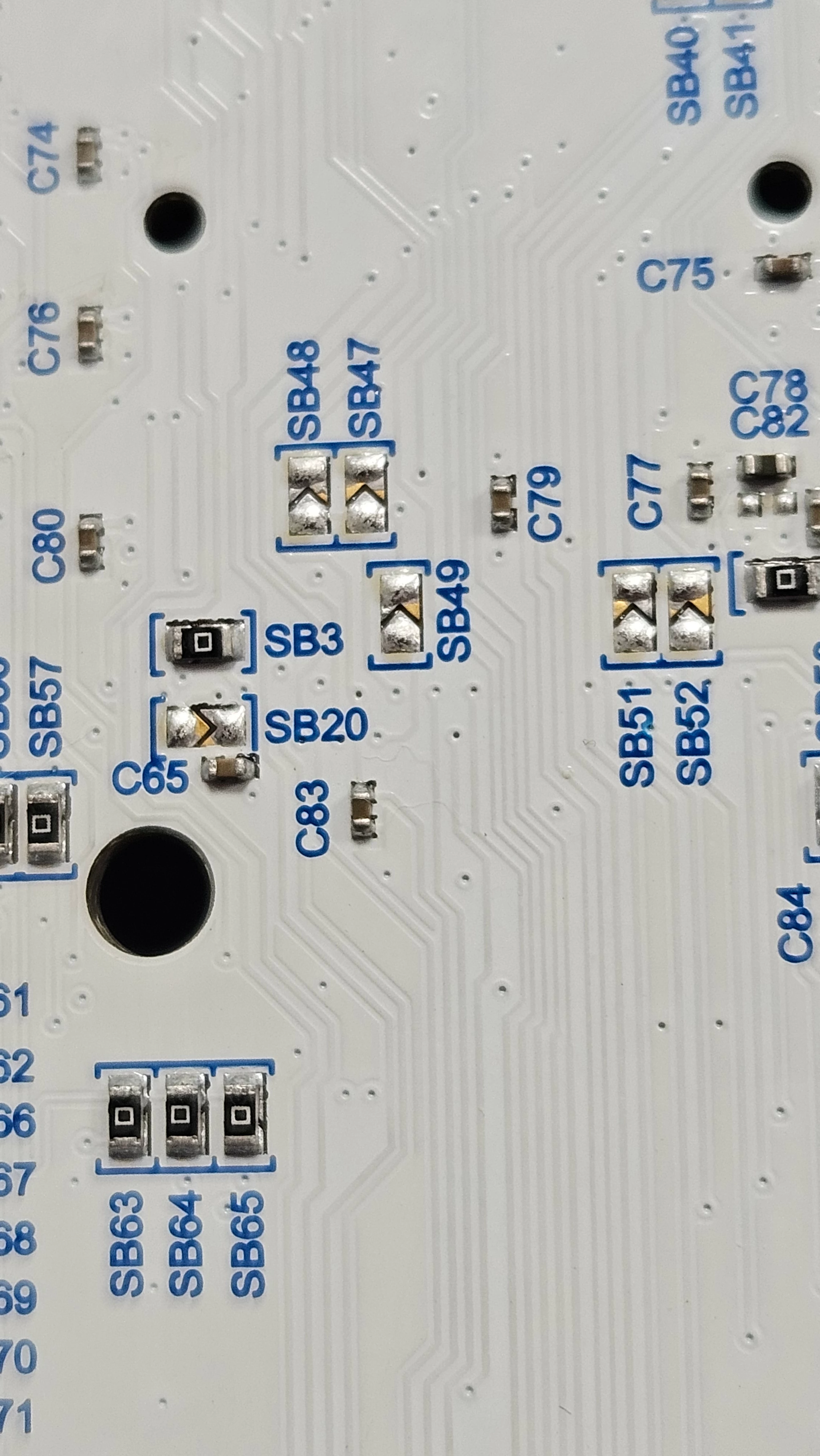

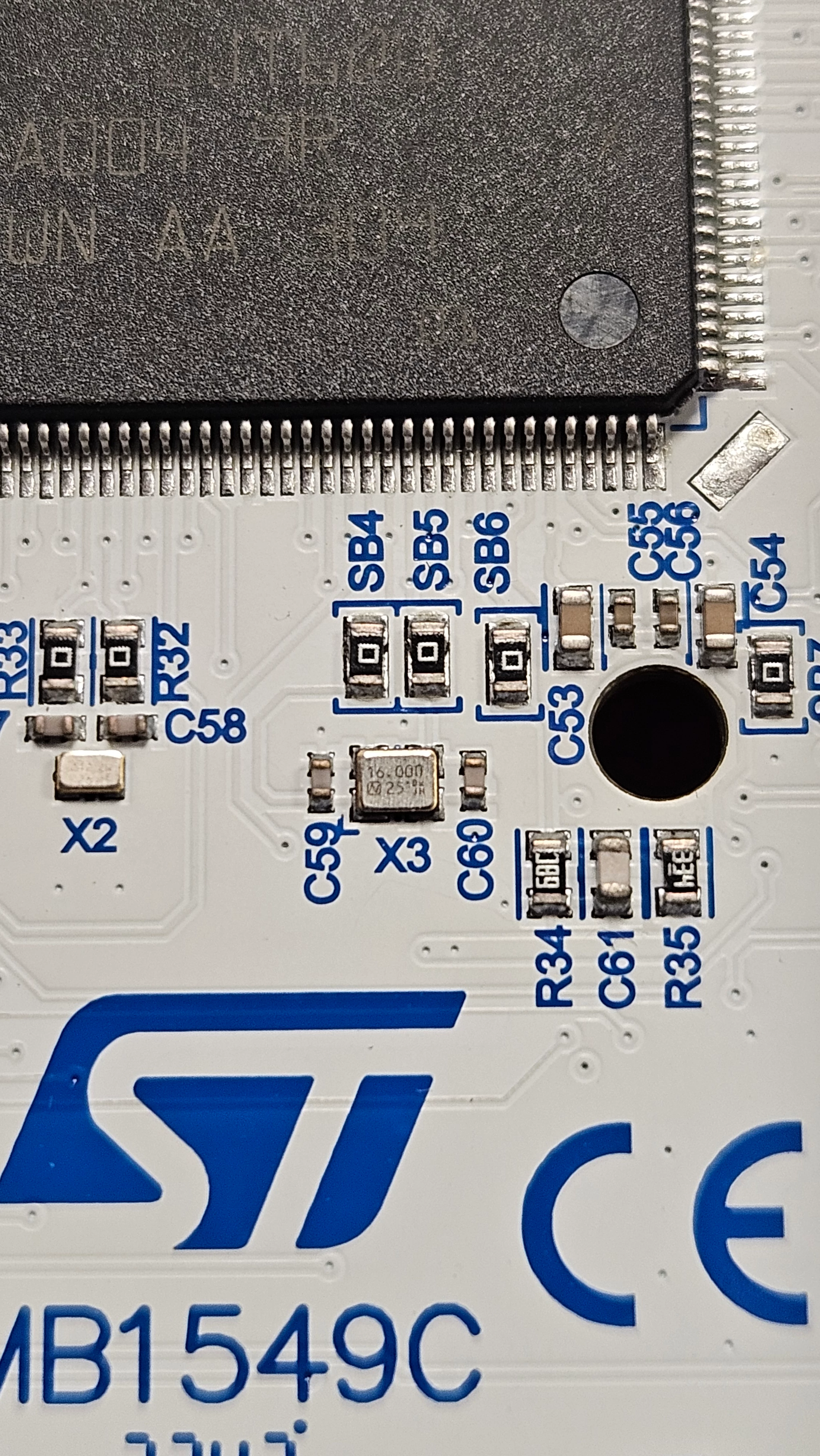

Jan 8, 2025 9:32 AM UTC
Facing the same problem here.
I've tried setting the input frequency to 16 as suggested, but that didn't help.
Any other solutions?
PS: I've downloaded and installed the latest versions of STM32CubeIDE and STM32CubeMX today.
Here are some detail pictures of my board. I think these are the correct default settings. (I got the board from a customer. I don't think they changed anything to the jumpers.)

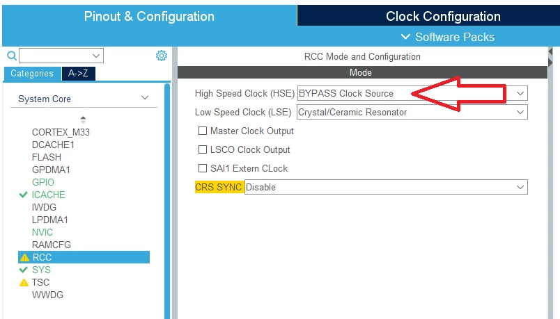

Graduate
Jan 8, 2025 12:10 PM UTC
Never mind. Found the fix.
The setting for HSE must be set to 'Crystel/Ceramic Resonator', just like with the LSE.
Now I can debug my project.
