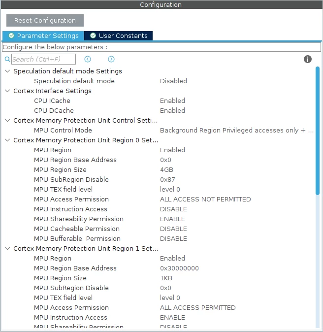

I have the same problem. @LEAMtw, I hope you don't mind if I add details here for my scenarios.
Error
Thread #1 [main] 1 [core: 0] (Suspended : Signal : SIGTRAP:Trace/breakpoint trap)
	MemManage_Handler() at stm32h7xx_it.c:105 0x8016138
	<signal handler called>() at 0xffffffe9
	ethernet_input() at ethernet.c:113 0x802e6c4
	ethernetif_input() at ethernetif.c:347 0x8023e18
	MX_LWIP_Process() at lwip.c:156 0x8023b6a
	Firmware::MainRuntimeLoop() at firmware.cc:101 0x80034de
	Boilerplate_Loop() at boilerplate.cc:16 0x80011d6
	main() at main.c:131 0x8015458

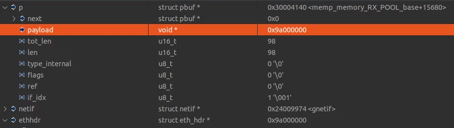

When debugging, I noticed that `p` buffer is valid, however, the payload is invalid.
	Details:0x30004140 <memp_memory_RX_POOL_base+15680>
	Default:0x30004140 <memp_memory_RX_POOL_base+15680>
	Decimal:805323072
	Hex:0x30004140
	Binary:110000000000000100000101000000
	Octal:06000040500
	Details:0x9a000000
	Default:0x9a000000
	Decimal:-1711276032
	Hex:0x9a000000
	Binary:10011010000000000000000000000000
	Octal:023200000000
In my case I am not using FreeRTOS, I am using a bare-metal approach instead.
Configuration

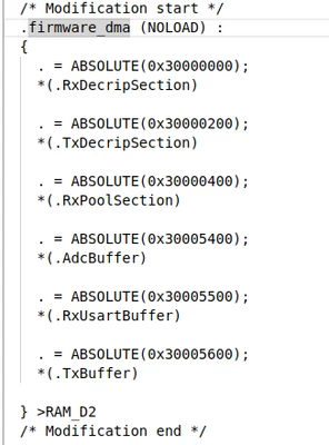

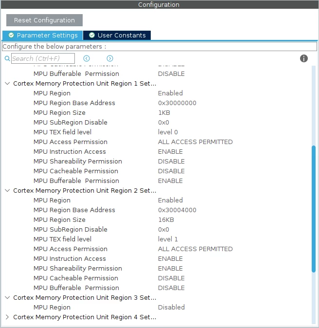

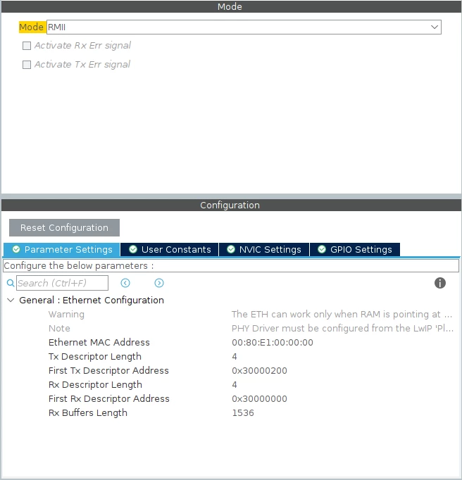

I have a STM32H723ZG. This is how things are configured.
## MPU
ETH
LWIP

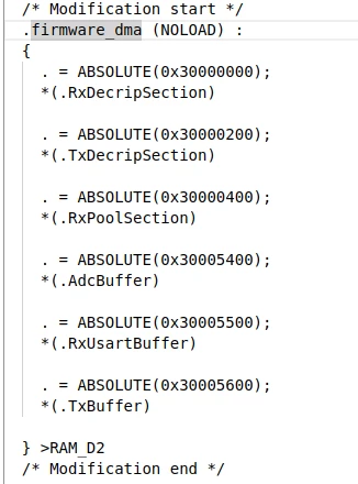

STM32H723ZGTX_FLASH.ld
7 replies

Have you tried the previous suggestions:
Are you passing auto data, so that the data is no longer valid by the time LwIP tries to access it?

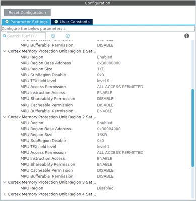

Configuration
MPU
ETH

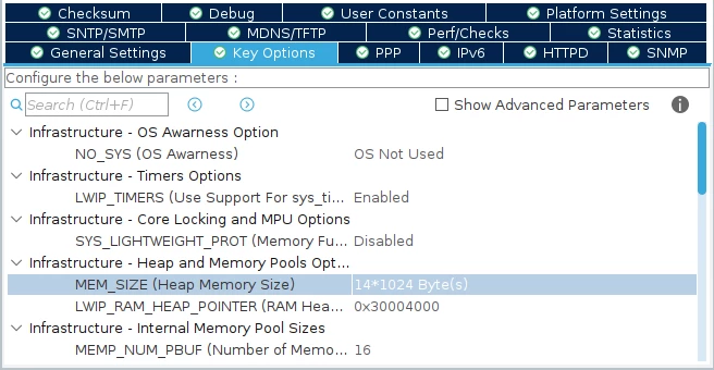

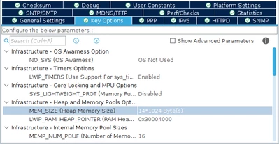

  • Increase stack size
  • Enable diagnostics
By stack size you mean LWIP MEM_SIZE? What should I estimate when defining the stack size?I have it as 14 KB, which to seems to be way above my needs.
