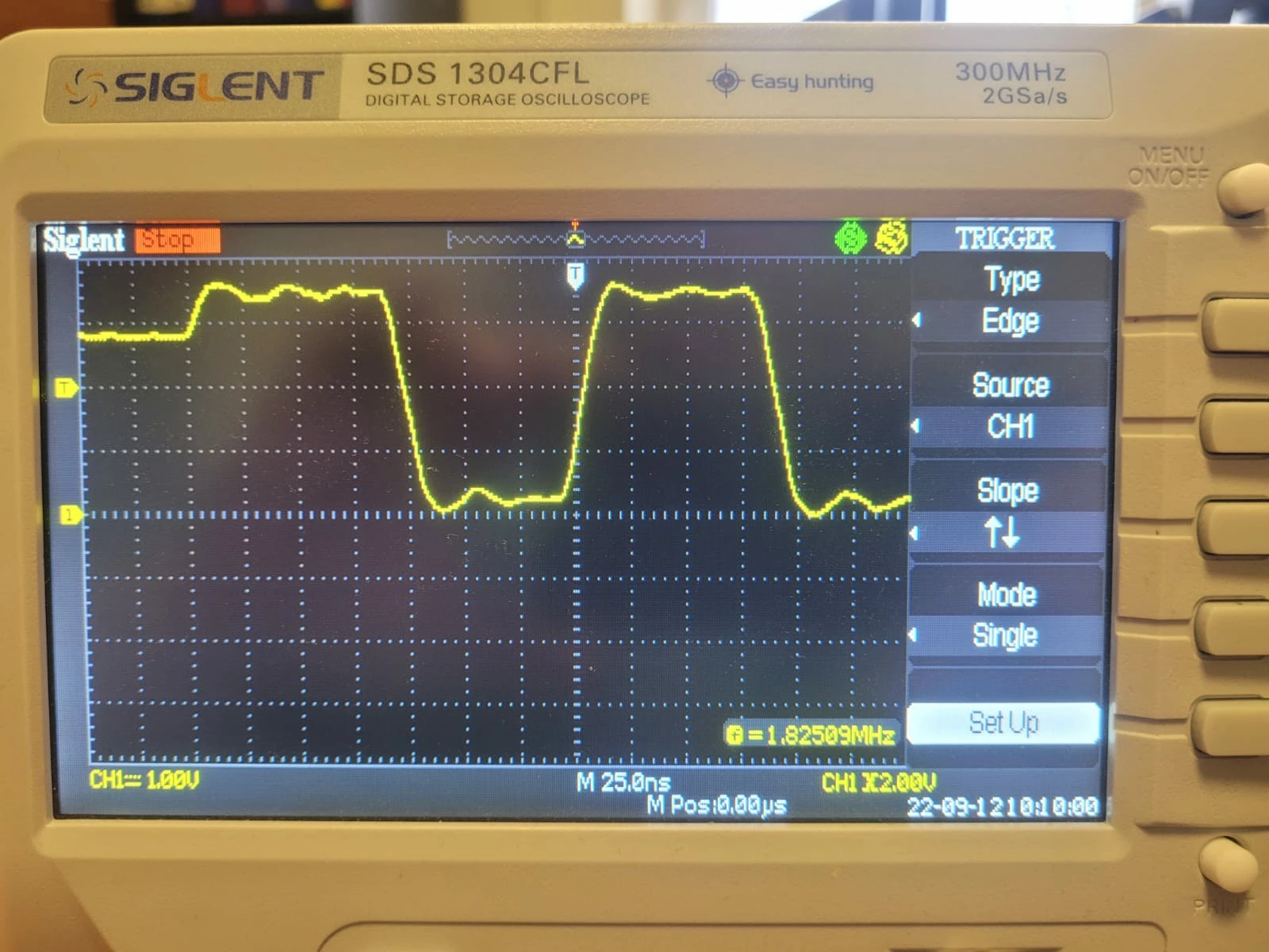

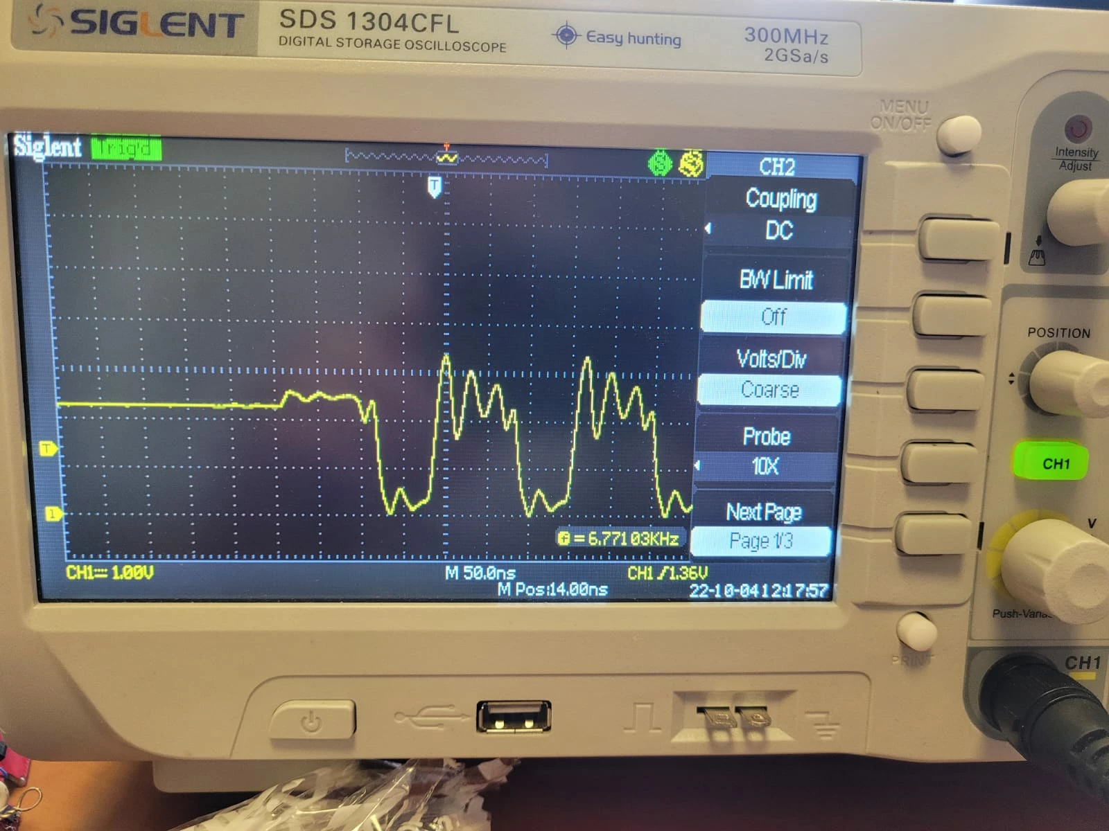

Rarely, USB does not work properly, and in parallel with USB malfunction, there are problems with data integration on the USART1 channel.
The above problems occur only with SOF packages with voltage distortion on USB lines: see oscillations on "USB signal with SOF" vs "USB signal with no SOF" when there is no oscillation and no problems indicated.
USB
Oscillations occur on SOF packages, they are not present on the "normal" transmission to the device.
It's about USB connected to USB H (not USB OTG).
The faster EHCI controller is disabled, the slower OHCI is enabled (due to forced FS transmission).
There were attempts with usb_phy_tuning, (various combinations of parameters) but it did not help.

Questions
1. Can the system (not the application) lose bytes in some way?
2. Is it possible to directly associate USART1 bytes loss with the USB problem as above (there is probably some connection between "clogging" USB and Mifare read errors).
We ask for help.
