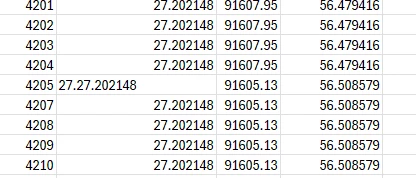

I am working on a data logger project using SDIO with DMA and FreeRTOS. The only sensor currently in use is the BME280, which is working fine. However, I am encountering issues when writing the CSV file, such as glitches, character repetition, and other seemingly random problems.

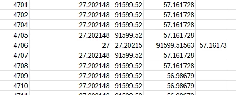

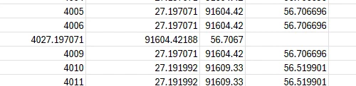

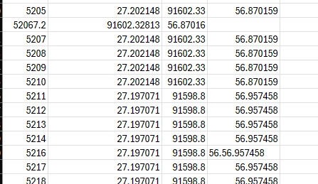

  • The issue arises when writing to the .csv file, with glitches, character repetition, and other random problems.
  • I have monitored the task stack, which is using about 500 words of the 9000 available.
  • I suspected that the problem could be related to the use of snprintf, but I did not find any issues like .. or .xx. in the buffer.
  • I tried increasing the clockdivider to 4, but the problem persists.
  • I believe the issue may be related to FreeRTOS preemption, but I have enabled NewLibReentrant and FS_REENTRANT, and no other task uses the SDIO or FATFS.
