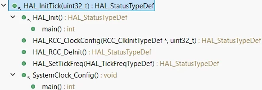

For setting up the Systick HAL_InitTick() is used. As the STM32H7 is running with 480MHz the systick gets loaded to 480000 every time. A screenshot auf the call hierarchy is added after the code segment.

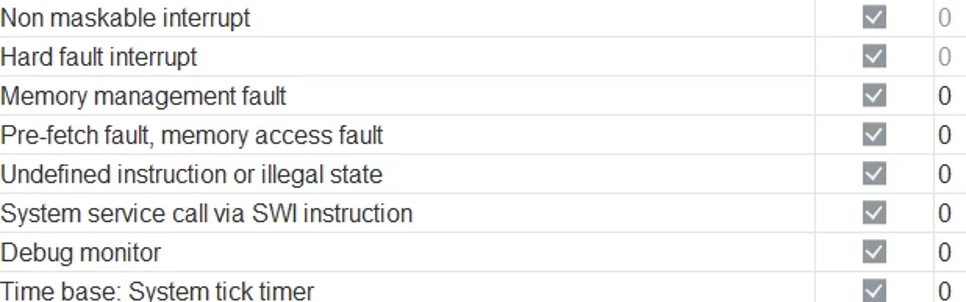

The Systick runs on Priority 0 and these are the following are the only other enabled Priority 0 NVICs. Furthermore  __disable_irq() is never used again in the whole project.

Heiko_SMAuthor
Oct 16, 2026 6:05 AM UTC
As mentioned in my post, SysTick has priority 0. The only other exceptions with the same or higher effective priority are:
  • non maskable interrupt
  • hardfault
  • memory management fault
  • pre-fetch fault memory access fault
  • undefined instruction or illegal state
  • system service call via SWI instructionand debug monitor
Therefore, I would not expect any of these to occur during normal operation without causing more obvious system issues.
