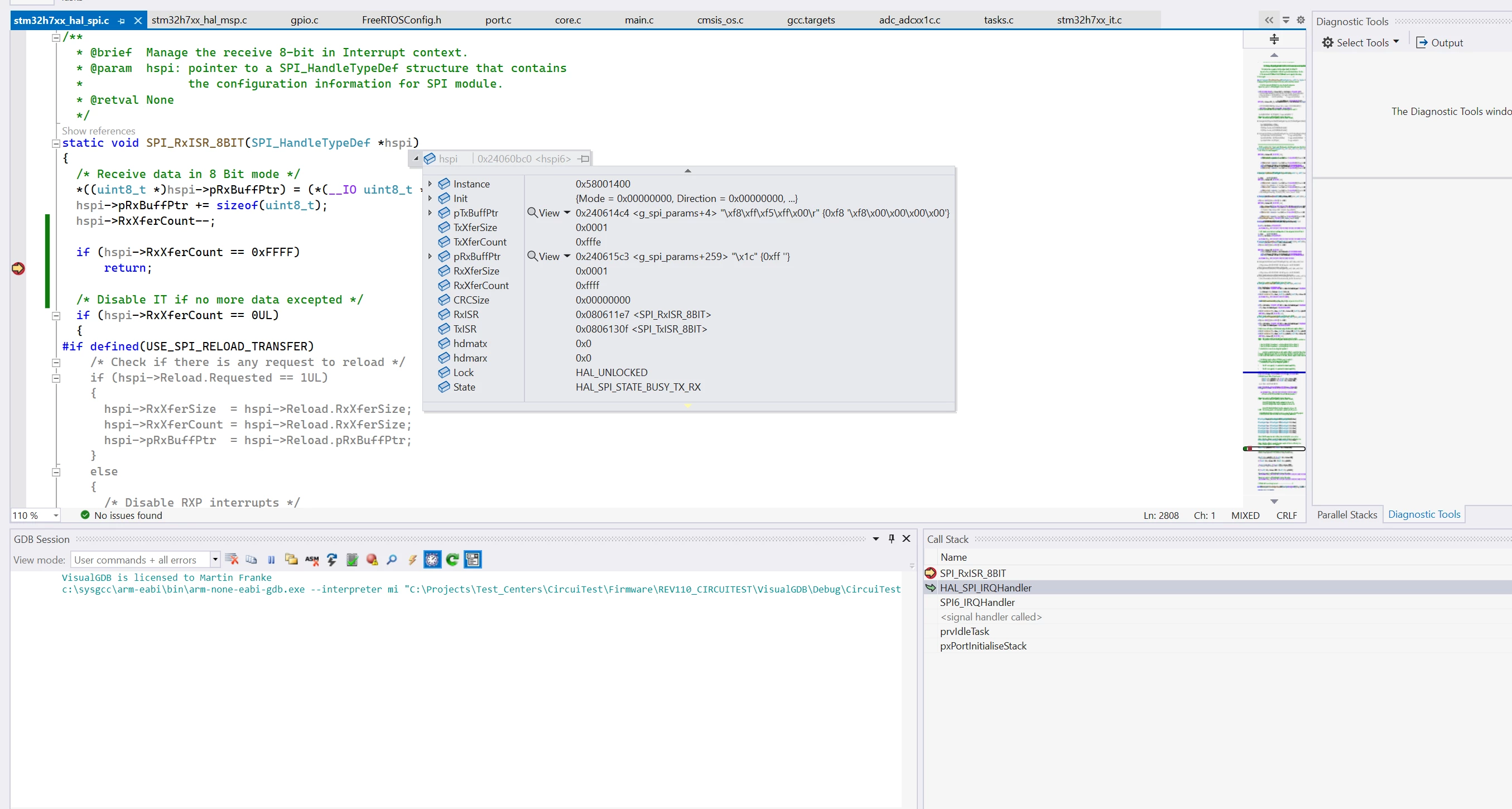

May 26, 2022 10:00 PM UTC
Hello ASELM,
I've experienced a similar problem with the related HAL SPI Driver in slave mode. I've found that indeed SPI_RxISR_8BIT(...) can cause the hspi->RxXferCount to decrement from 0 to 0xFFFF (this is very similar to the UART_RxISR_8BIT(...) function described above). In my case it is occurring in STM32H7 based hardware we use to test various projects (Using HAL 1.10.0 for STM32H7) and it happened while I was testing a device with a bad CS line on SPI, hence a data underrun occurred. Our software causes it to retry several times and I find usually while this is occurring at some point it will hit this situation. I would have assumed this wasn't possible due to what you say about the lack of ability to pre-empt an interrupt, however somehow it is getting called again after it has been set to 0, even though it should have disabled the interrupt by that point. Also, HAL_SPI_TransmitReceive_IT() prevents size from being set to 0, (and I'm never setting it to 0 anyway), so I don't think the issue is on that end. I'm still investigating but thought I'd post this to suggest that between the issue above, and mine, you might look a bit closer here. I suggest creating an underrun condition and retyring several times. Attached is a screenshot where I added a catch to show an instance where this occurred.
