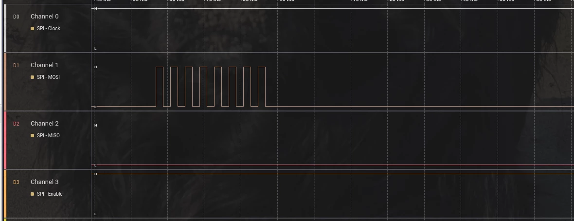

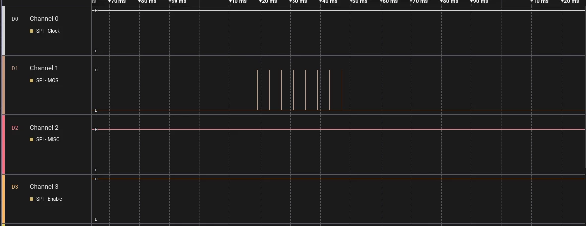

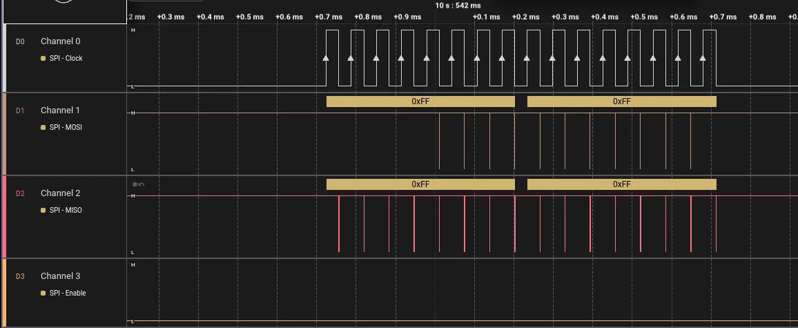

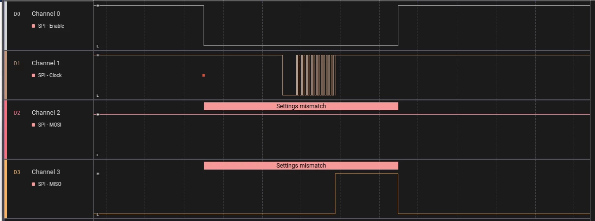

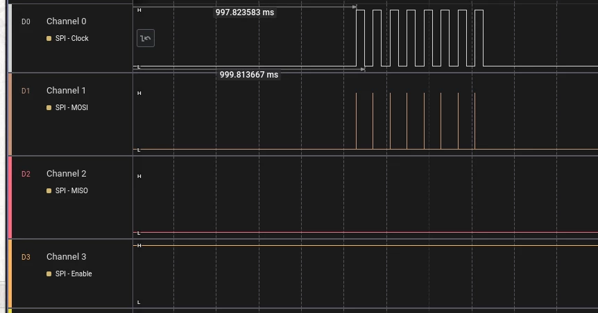

It's my first post and I'm trying to make something with the SPI but I met the problems. Even if I configure the interface (hopefully correctly), I can't communicate with any SPI device. I bought BMP280 as a simple sensor to communicate with. What I'm trying to do is to read DevID. It should be done by writing 0xD0 and then reading a byte (expected 0x58).
But it's not working at all. Using logic-level analyzer I have noticed something weird - bytes sent by SPI are delayed by about half a period of the signal. About, because it's not equal between the next attempts... I have set CPOL=CPHA=0 on both STM32H7 and the analyzer. If I change one side to CPOL=0 && CPHA=1 then I get the expected data (decoded) but only sometimes and only on the MOSI (0xD0 sent). The screens below show both situations.
CPOL=CPHA=0 Both
CPOL=0 CPOHA=1 One side
I have checked connections, I have checked the sensor (with the different MCU, not STM), and I have checked different pin configurations. I even tried to use AruinoSPI with PlatformioIDE. No matter what am I doing I'm getting similar results - random bits on the SPI...

Looks like a hardware issue, not a code issue. Looks like MOSI and MISO pins are shorted high, or something else is competing for their use.
Which pins? Check the schematic to ensure these pins are available for use and not being used by something else. Very likely this is the issue.

I have followed your advice but it's not the problem. Okay - this time I've got proper readings every time (0xD0 on MOSI) but ONLY if I set CPOL=0 && CPHA=1 on the one side.
I'm using module from Botland  and here's the Datasheet.
The connection is:
STM32 | BMP
PC2_C -> SD0 (MISO)
PC3_C -> SDA(MOSI)
PD3 -> SCL
PB9 -> CSB
3V3 -> VCC
GND -> GND

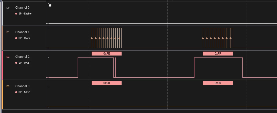

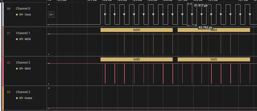

But as I mentioned - the behavior without the sensor is similar. Short peaks on the MOSI line are also confusing for me.
Sebastiaan
Jan 5, 2024 1:47 PM UTC
I've used SPI plenty of times, and this pattern on the MOSI is not normal. Was this monitored with the BMP disconnected? If not please, do that first to verify your MOSI output.
Then you can hook up the BMP again. If the BMP messes up the MOSI signal, it means that it's incorrectly connected.
Another thing that could help is to set CS high and low again after each transfer, if there's any clock mismatch between the 2 devices, that should recover it. Make sure it's long enough (so use HAL_Delay(1)).
Also, why are you not using the HAL SPI functions? For example HAL_SPI_TransmitReceive?

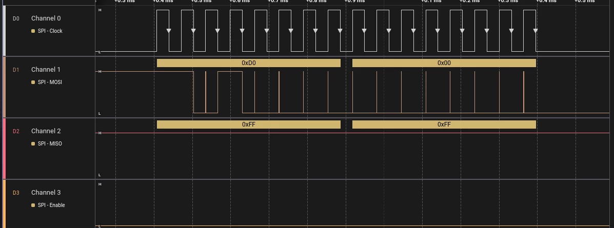

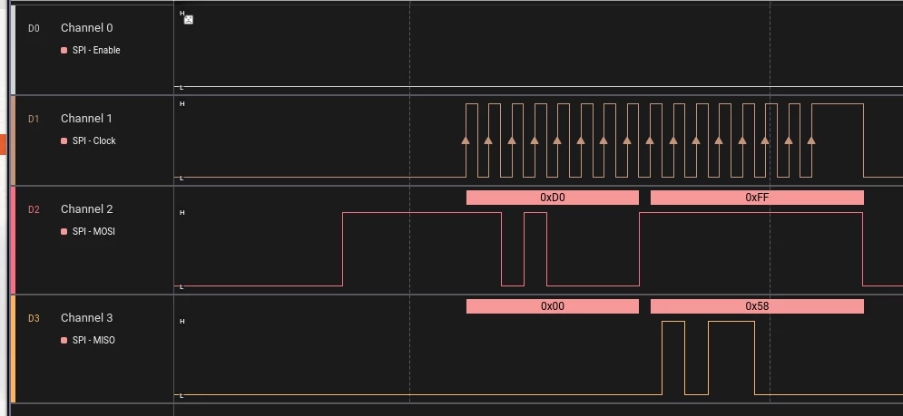

My previous answer in measured without BMP connected. Only the logic-level analyzer and board.
@Sebastiaan I decided to use registers instead of HAL because I had the same problems with it so I thought maybe something was wrong with SDK.
I have changed main() to HAL:
int main(void)
 HAL_Init();
 SystemClock_Config();
 MX_GPIO_Init();
 MX_USART3_UART_Init();
 MX_SPI2_Init();
 printf("Start\n");
 HAL_Delay(1000);
 uint8_t tx_data[32], rx_data[32];
 tx_data[0] = 0xd0;
 tx_data[1] = 0xff;
 HAL_GPIO_WritePin(BMP_CS_GPIO_Port, BMP_CS_Pin, 0);
 HAL_Delay(100);
 HAL_SPI_TransmitReceive(&hspi2, tx_data, rx_data, 2, HAL_MAX_DELAY);
 HAL_GPIO_WritePin(BMP_CS_GPIO_Port, BMP_CS_Pin, 1);
 while (1)
But the result is similar (peaks and mismatches in CPOL/CPHA)

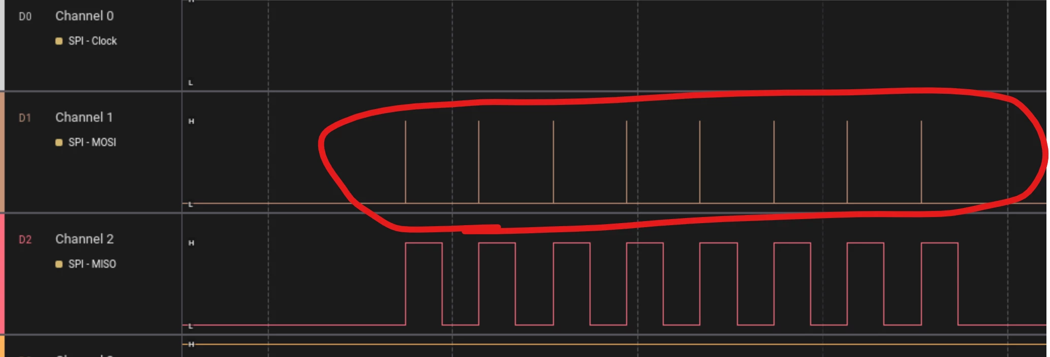

@TDK I have changed main to toggle the pins:
MX_GPIO_Init()
 /*Configure GPIO pins : PC2 PC3 */
 GPIO_InitStruct.Pin = GPIO_PIN_2|GPIO_PIN_3;
 GPIO_InitStruct.Speed = GPIO_SPEED_FREQ_MEDIUM;
 HAL_GPIO_Init(GPIOC, &GPIO_InitStruct);
int main(void)
 HAL_Init();
 MX_GPIO_Init();
 printf("Start\n");
 HAL_Delay(1000);
 for(int i = 0; i < 16; i++)
	 HAL_GPIO_TogglePin(GPIOC, GPIO_PIN_2);
	 HAL_Delay(1);
 while(1){}

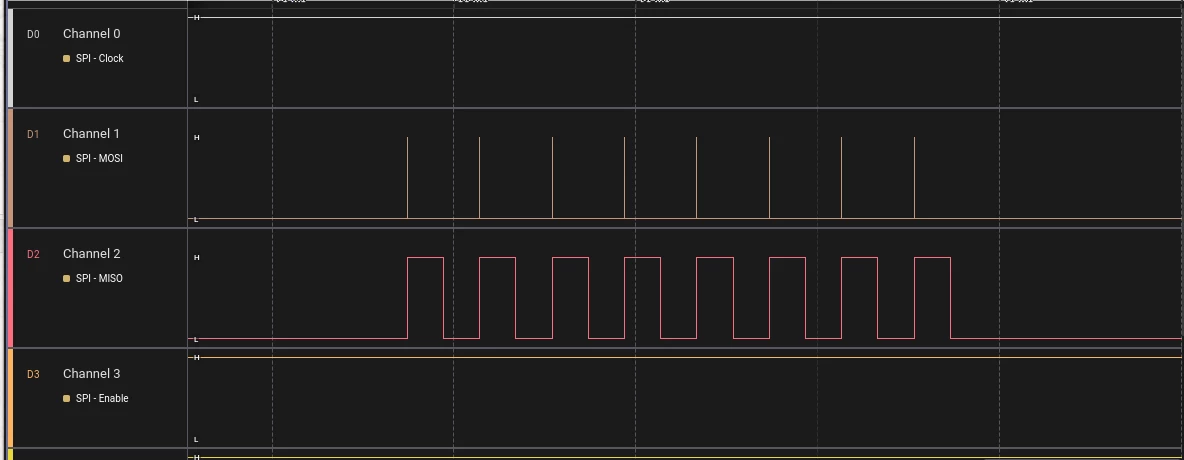

And something happened... I've peaks on MOSI, switching MISO
But everything is okay while switching MOSI

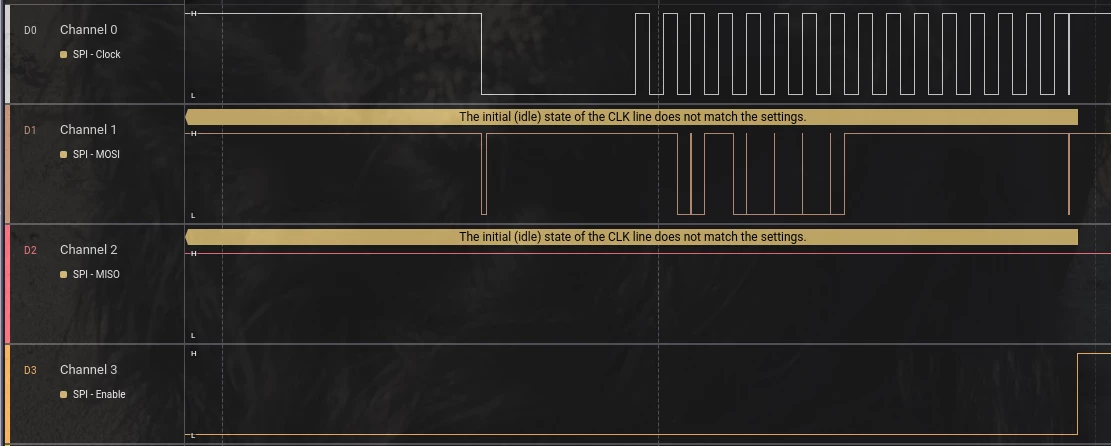

So It's not short between lines. It happens even if I disconnect MISO from the analyzer while switching.
Sebastiaan
Jan 5, 2024 3:16 PM UTC
That's a good suggestion of @TDK, and shows there's a certain type of coupling.
You've never mentioned on what kind of platform you're working, that's becoming more important now. Is it a custom board, or an stm32 nucleo board? Or something else? Even if there's no short, there might be another component connected to the same ports? Can you look in the schematics?
Also, the glitches on the MOSI while doing the SPI transfer via HAL library are not the same anymore, they're only seen on the first byte now. Not sure what's the reason for that, maybe it's due to the CS that you're using now. You could also try to repeat the toggle test on the clock, and see if you see again the same glitches on MOSI.
But all of this is pointing towards some board issue, the code itself seems fine.

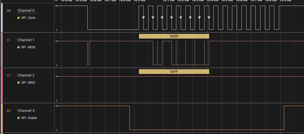

Sorry, but I forgot about it before. Switching SCK also results in MOSI peaks.
I'm using Nucleo-H743ZI2 (NUH743ZI$AT3). I looked at the schematics before I posted (schematics). Nothing is connected to PC2/3 or PD3. PD3 can be used with USART as a CTS but I'm not using Flow Control. To make sure I removed USART from my code but nothing changed (peaks are present as above).
Just for the test, I have switched to Hardware NSS but nothing changed.
(CPOL=0 && CPHA=1)
Jan 5, 2024 6:09 PM UTC
No problems with MISO signal. The MOSI signal is still garbage.
If you have nothing connected to that pin during this test, the hardware is faulty (or your logic analyzer channel is broken. Swap channels to eliminate that possibility.). You'll have to get a new board.

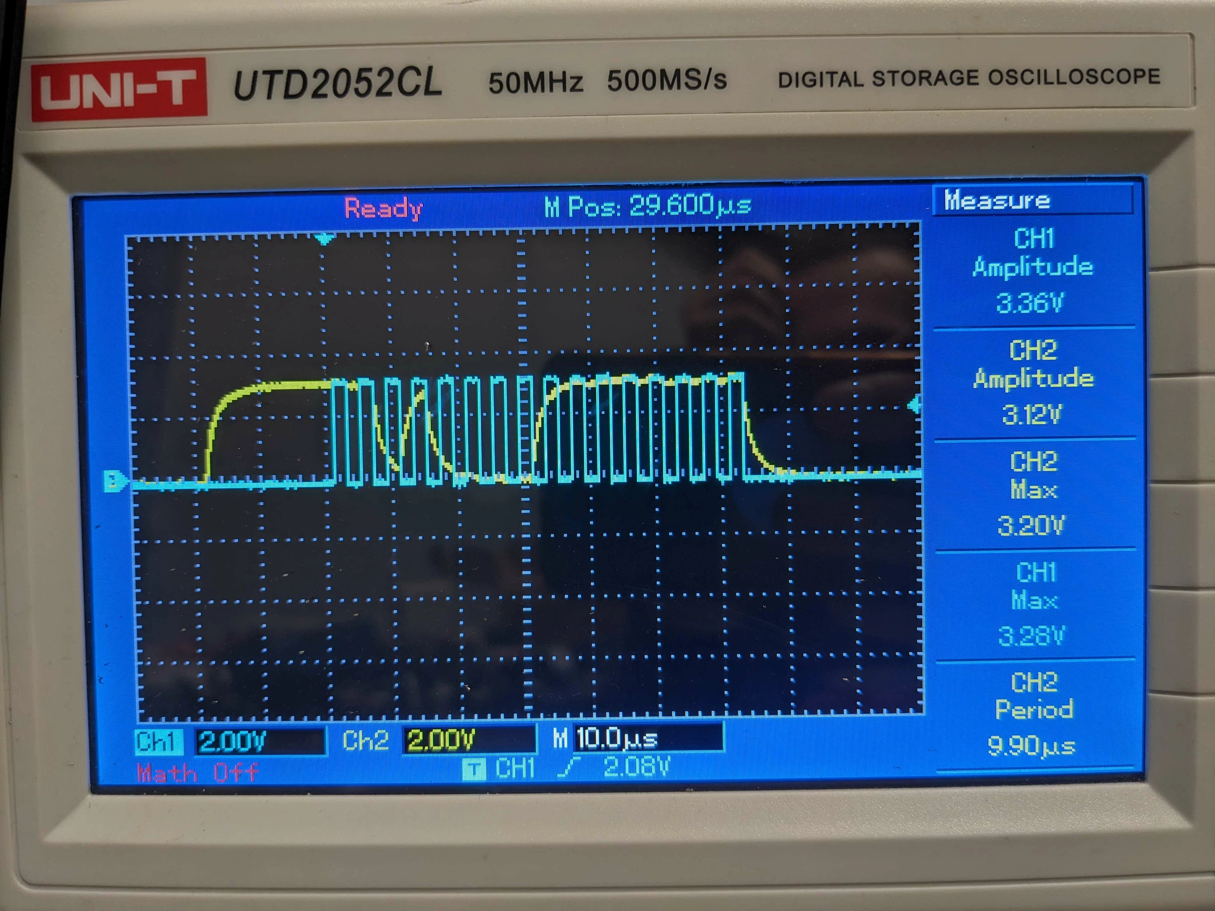

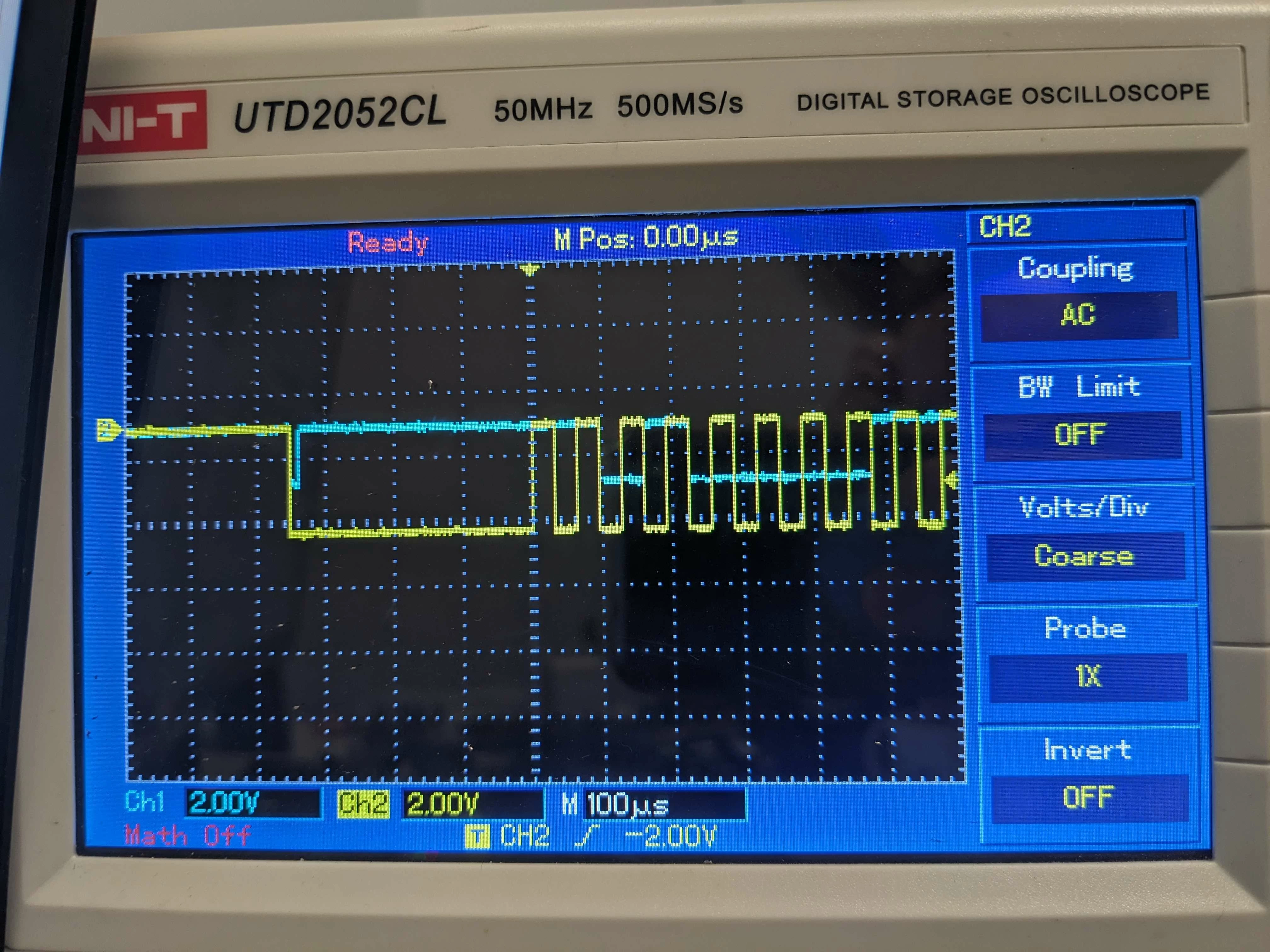

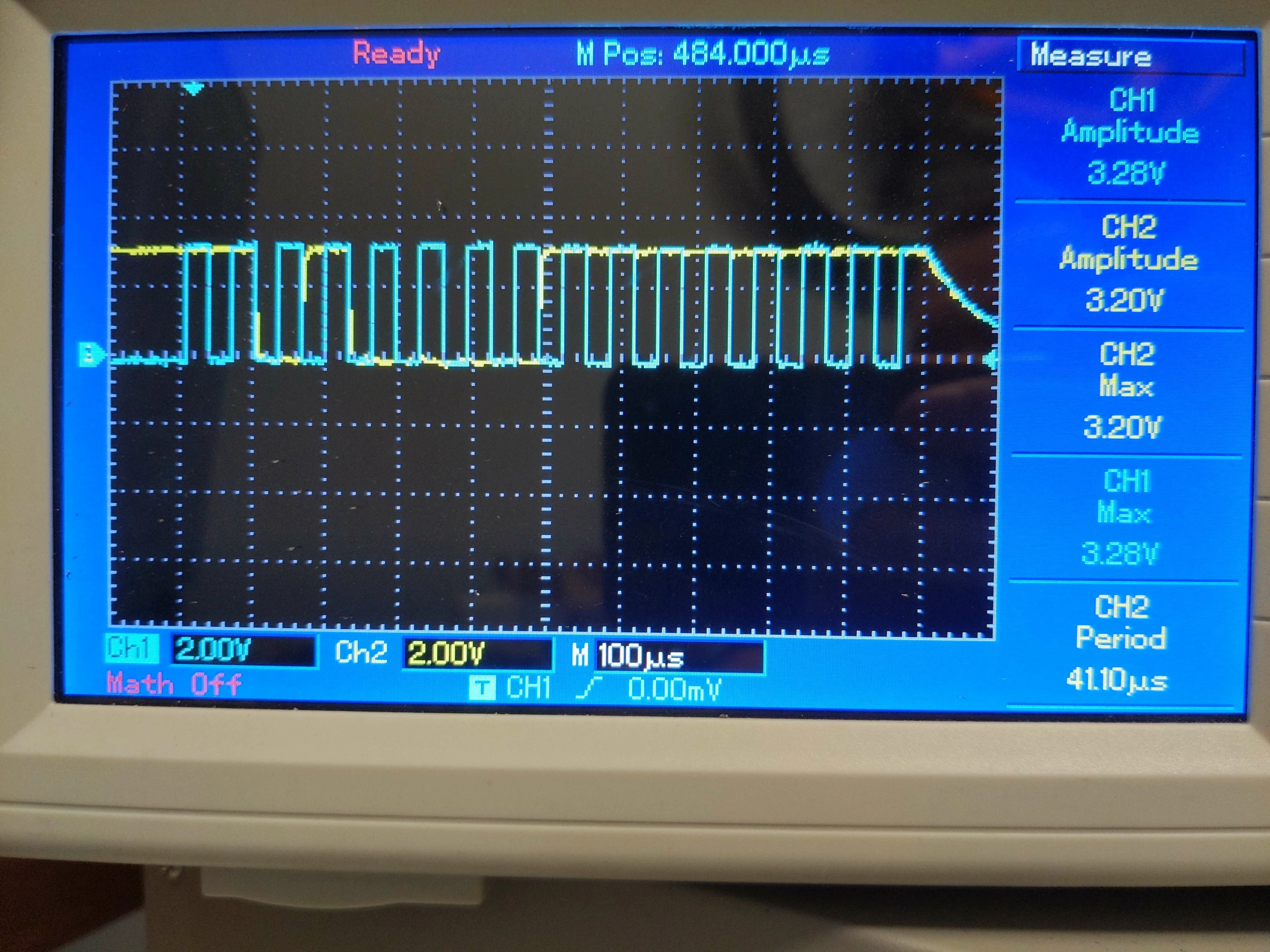

It might be informative to take an analog capture of this signal (the GPIO output toggling test on the MOSI pin), though it won't solve the problem.
Jan 7, 2024 9:10 PM UTC

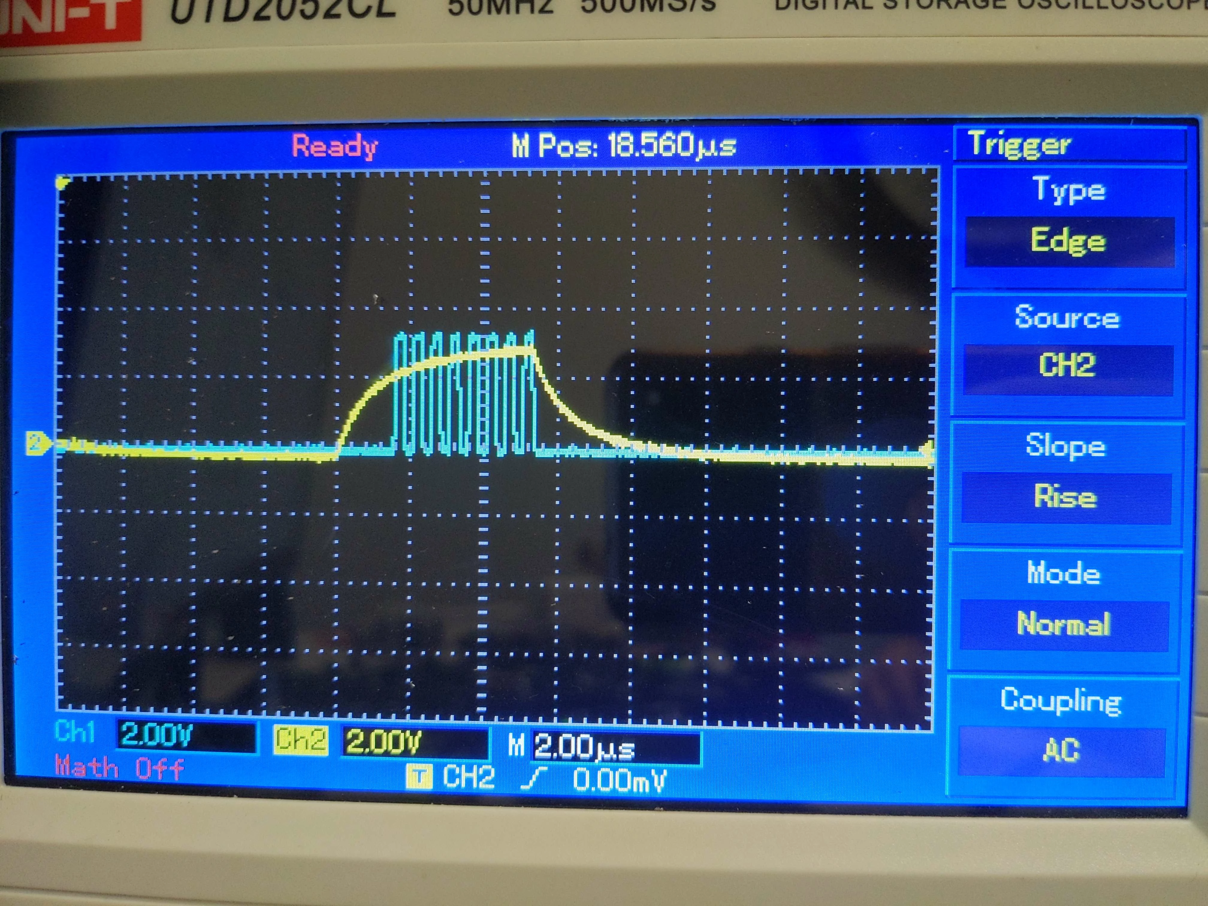

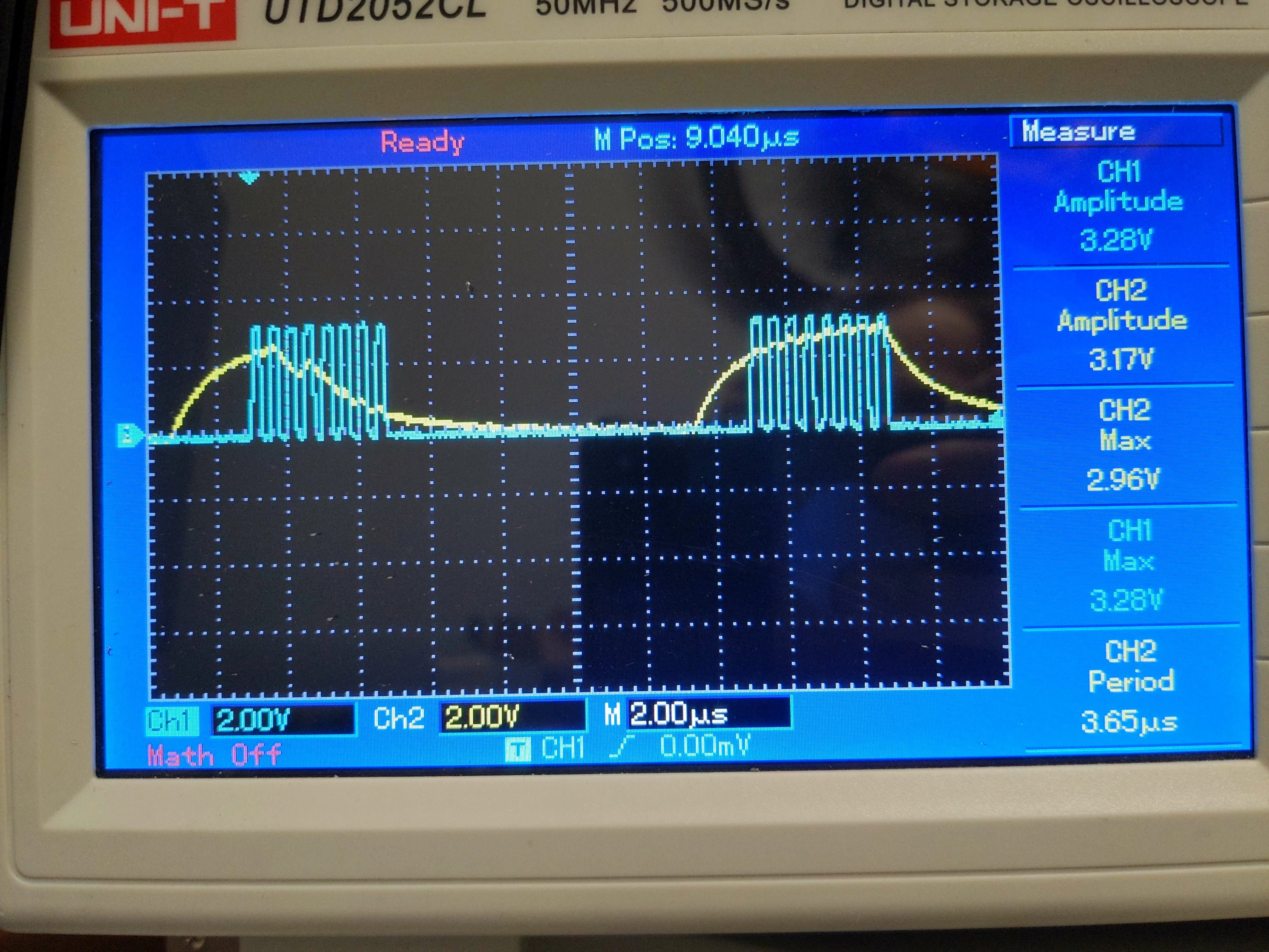

I got an oscilloscope and here's the result and other Logic Analyzer. Conclusion:
- Peaks came from a probably broken Logic Analyzer. Something was wrong internally, maybe just separation between channels.
- I noticed that every module I tried to use had pull-ups on every line (SCK/MISO/MOSI). After removing it I saw the correct signal BUT only in low-frequency signals. Let me explain with the pictures (sorry but my oscilloscope couldn't get a print screen...):
1) I achieved proper communication using both the HAL and registers approach.
a) BMP280 connected to the NUCLEO.
b) Pull-up resistors removed.
c) Oscilloscope probes connected to 2cm wires, soldered directly to the MCU.
d) Prescaler == 256 (15KBit/s)
e) Oscilloscope channel 1 - SCK; channel 2 - MOSI
2) In my target project I will need higher SPI speeds. So I started to change it. Communication (digital) looks fine but I have noticed something alarming on the MOSI pin. The signal was affected by some capacitance.
d) Prescaler == 16 (250KBit/s)
3) I changed the prescaler and now communication was impossible.
d) Prescaler == 2 (2MBbit/s)
4) I thought the sensor could cause it so I removed it. Nothing changed. Some capacitance on MOSI line broke the signal. So here's my first question: What could cause the capacitance on MOSI pin if nothing is connected?
a) BMP280 NOT connected to the NUCLEO.
b) n.a.
5) Then I soldered the resistors again and I got the result similar to that described last days. BUT Oscilloscope showed something weird. MOSI signal looked almost perfect but its amplitude was equal to half of expected. So when SCK was jumping between 0-3.3V, MOSI couldn't achieve 0V, oscillating between 3.3-2V. So if I manually wrote bits I got the expected 0xD0 but because 2V is too high to be recognized as LOW, I got 0xff and I couldn't communicate with the sensor. I have checked the sensor with atmega and it worked without any problems. So Do you have any idea, why MOSI with pull-ups couldn't go below 2V? I know SPI doesn't need pullup/down, but it should work with it. Especially with lower speeds. For me, it's not related because the signal is sharp and right placed.
b) Resistors soldered to BMP280 (SCK/MISO/MOSI; 10kOhm)
d) Prescaler == 256 (15KBbit/s)
e) Oscilloscope channel 1 - MOSI; channel 2 - SCK
TDKBest answer
