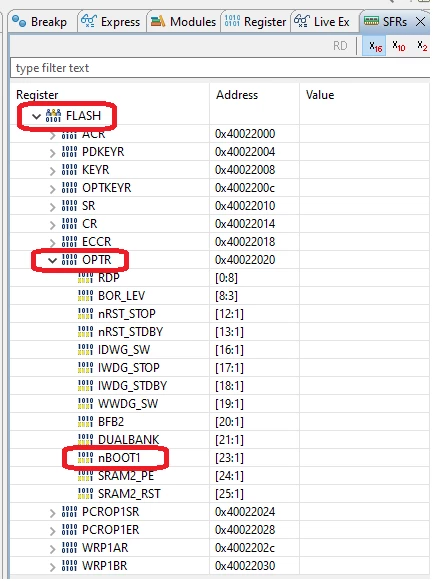

And about the ' FLASH_OPTR' register, in the STM32CubeIDE, for the MCU that I'm working with (STM32L4A6AGIX), there is no an field called nBOOT0 & nSWBOOT0, as shown in the attached picture.
So how can I configure BOOT0 now, that in a programmatically way, the MCU will load the burned program, from flash to adress 0x00000000, and will run the program after turning it on.

The option bytes are in addresses 0x1FFF7800-1FFF7820 (bank1)
On your picture are shown the flash control registers. They reflect the state of the option bytes in runtime.
The Segger J-LINK forum is here. You can ask them directly.
Their J-FLASH software has kind of scripting ability, one can write a script to manipulate the flash registers.
The best IMHO is to follow the advice of @Piranha : write a small program to set these bits. And be done with it. Run it in RAM, if your debugger allows this.
