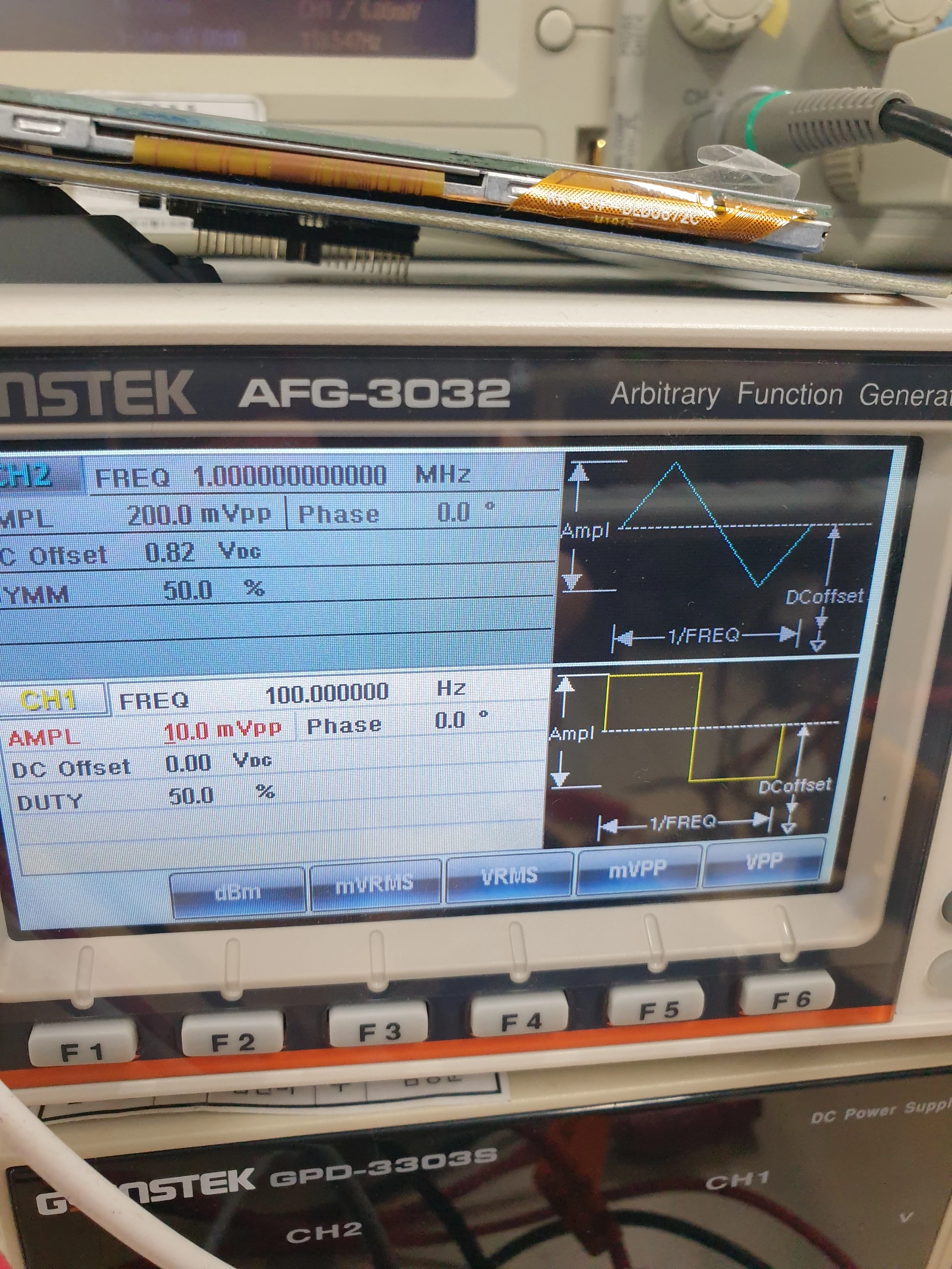

  • Input wave : 100Hz 10mVpp square wave(to CN6 Left pin)0693W00000LzPa0QAF.jpg

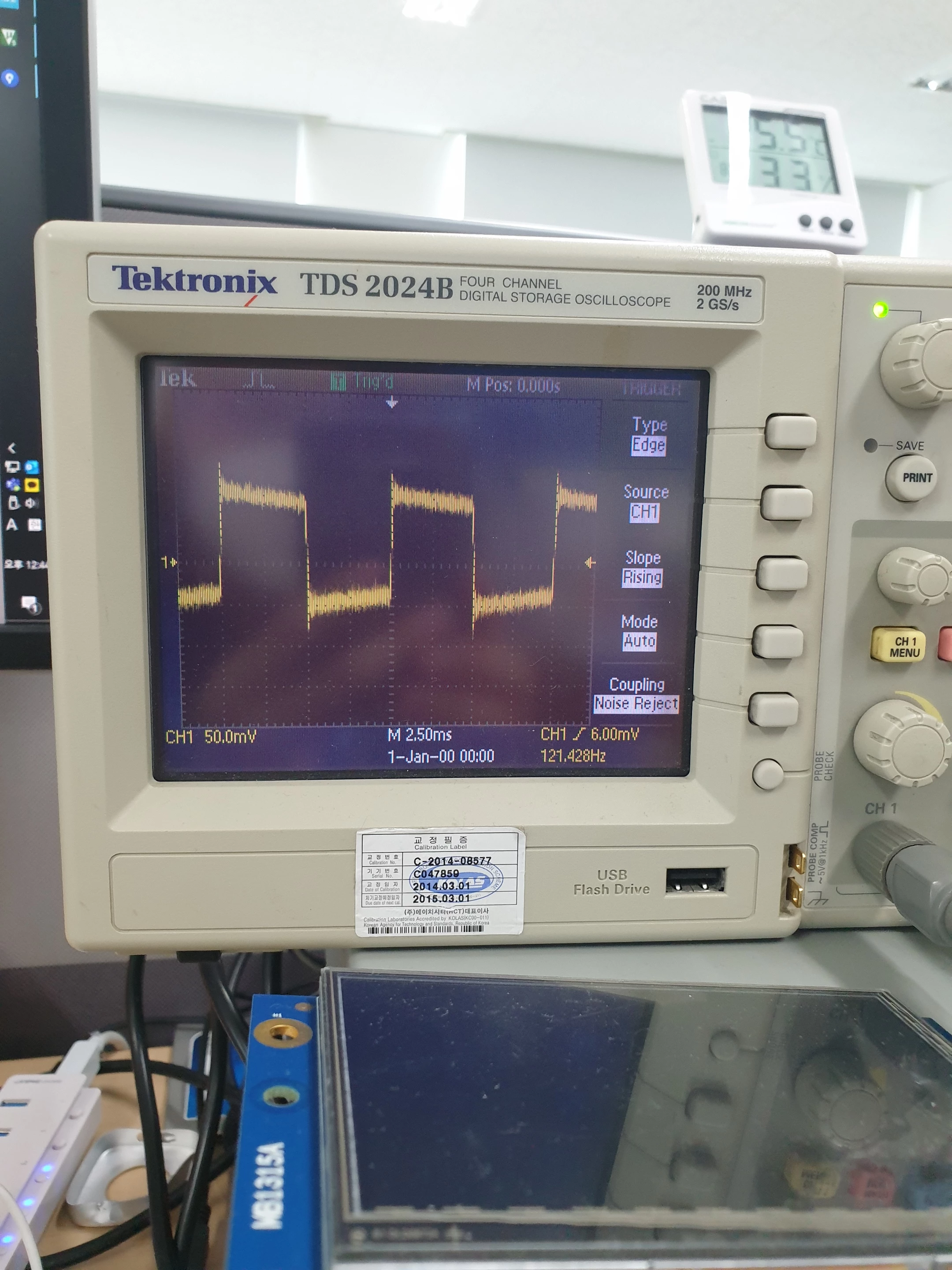

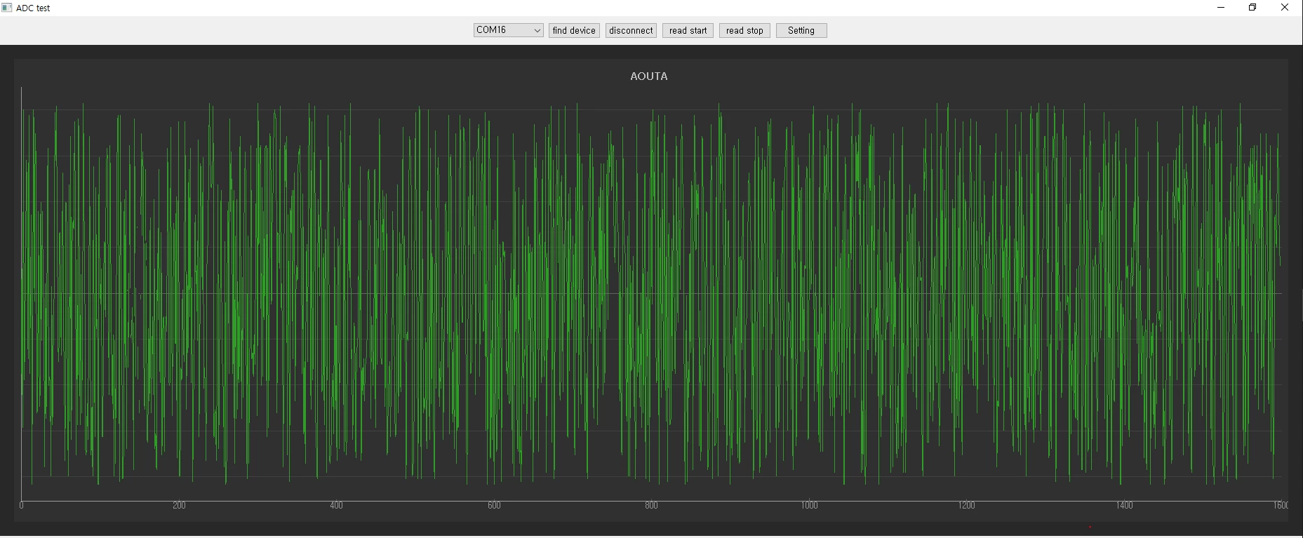

But, when i convert input data to integer value, the result was not square wave.
I sent data to desktop using uart. Below picture is result.
0693W00000LzPaoQAF.png​

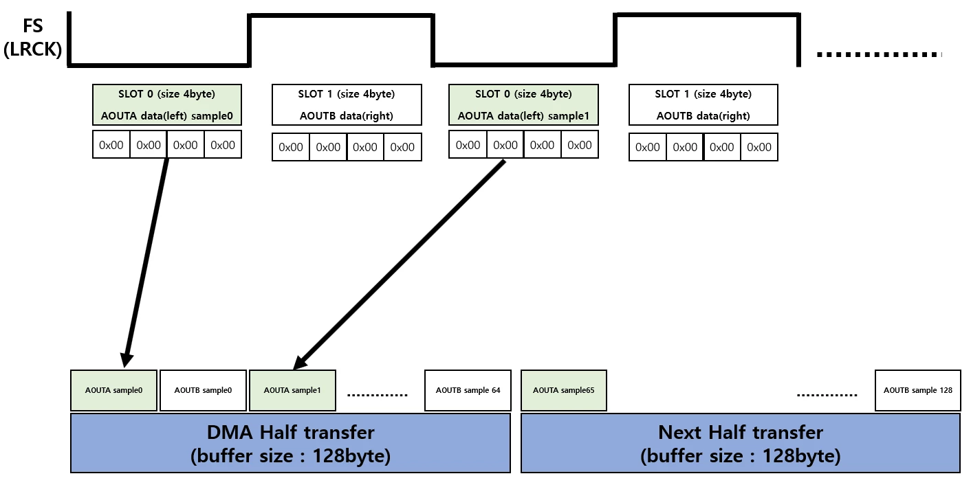

I think the dma and SAI buffer work as below.
Is it right?
0693W00000LzPfFQAV.png​

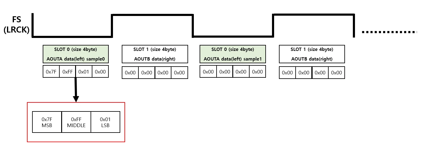

I convert 24bit data using below code.
def byte3_to_integer(value1, value2, value3):
 d1 = value1 & 0x7F
 d2 = value2 & 0xFF
 d3 = value3 & 0xFF
 result = (d1 << 16) + (d2 << 8) + d3
 if (value1 & 0x80) == 0x80:
 result -= 0x800000
 return result
Is there anything wrong in the process of converting sample?
