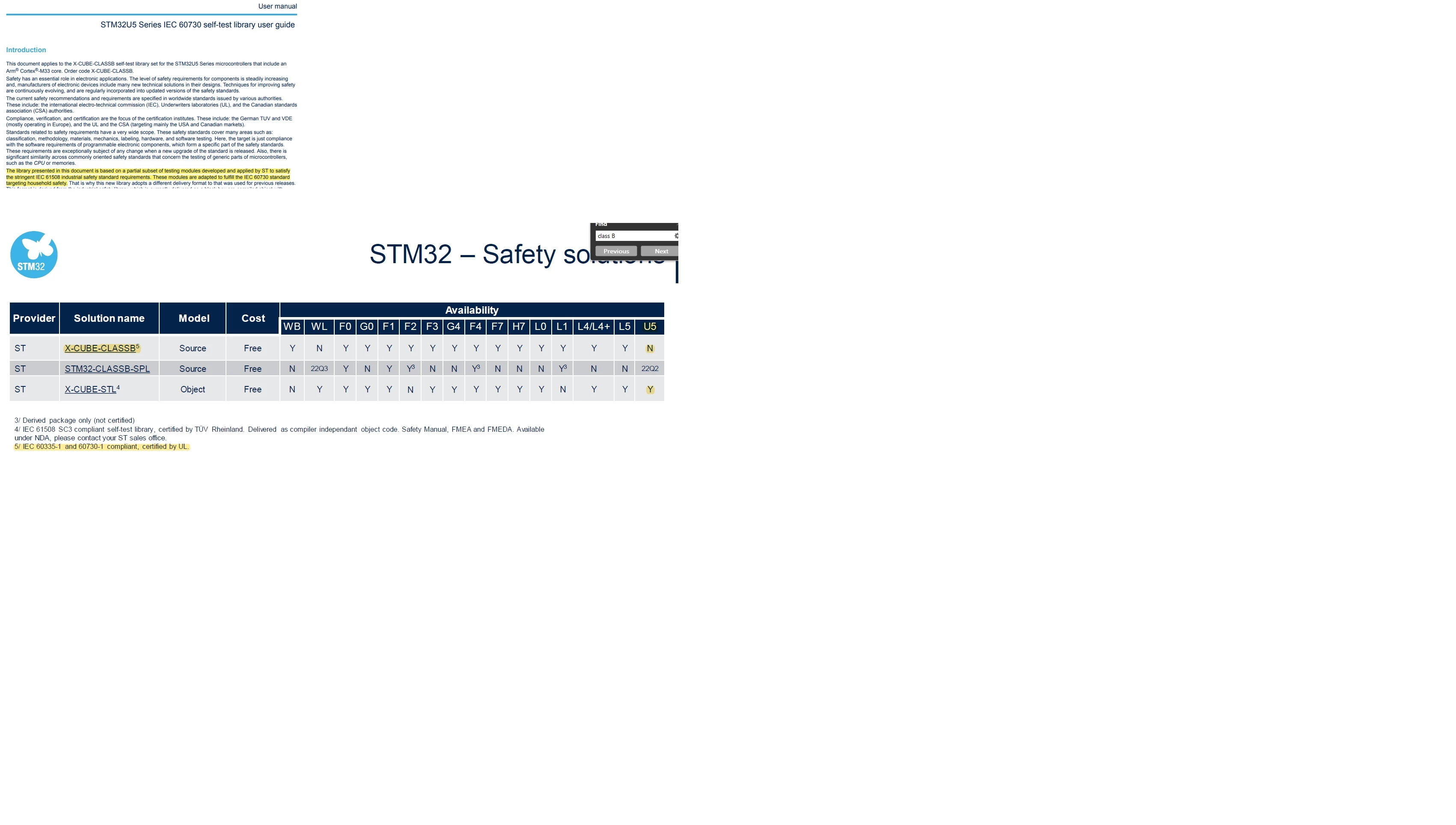

We are selected Trustzone MCU STM32U585ZIT6Q for our product we have some queries regarding the certification
Based on the attached user guide snapshot, we could understand this U5 series chip have a Class B library that supports IEC 61518 and was adopted to fulfil the IEC60730 requirement.
Is that ok to proceed with UL1998/IEC60730 certification by integrating the ClassB STL library for the U5 series?
Also, could you share the latest UL-compliant certificate for the STM32 U5 series?

X-CUBE-CLASSB for STM32U5 series is indeed available on st.com.
This is the X-CUBE-CLASSB-U5, rev4.0.0, delivered as compiler independant certified object code, with the associated UL certificate.
The package contains project examples with trustzone enabled or trustzone disabled. Please download the package and refer to the readme file and user guide.
