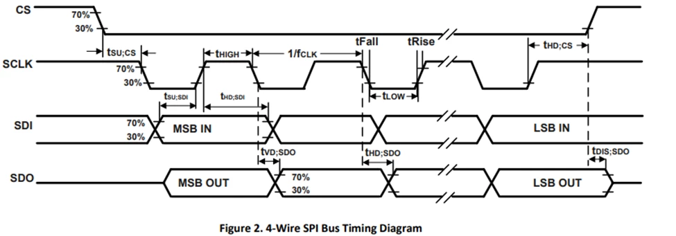

As per ICM-42688 4 wire SPI timing diagram and spec, we conclude that it will work on Motorola NSS

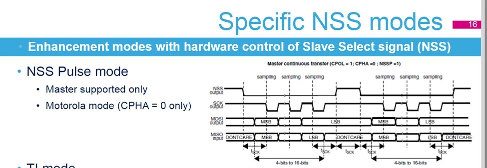

Later, surfing the google regarding this issue, I came across this document “STM32L4 - SPI Serial Peripheral Interface REV 2.0”. In this, it is mentioned that Motorola will support only CPHA =0.
Is there a way to communicate with Motorola NSS mode with (Clock polarity 1 and clock phase 1(2nd edge)) using STM32L4 EVK?

According to ICM-42688-P datasheet chapter 9.6.SPI INTERFACE: CS goes low (active) at the start of transmission and goes back high (inactive) at the end.  It means, you are not supposed to pulse NSS between bytes, thus you don't need to set STM32's SPI to "NSS Pulse mode" and thus the CPHA restriction does not apply.
