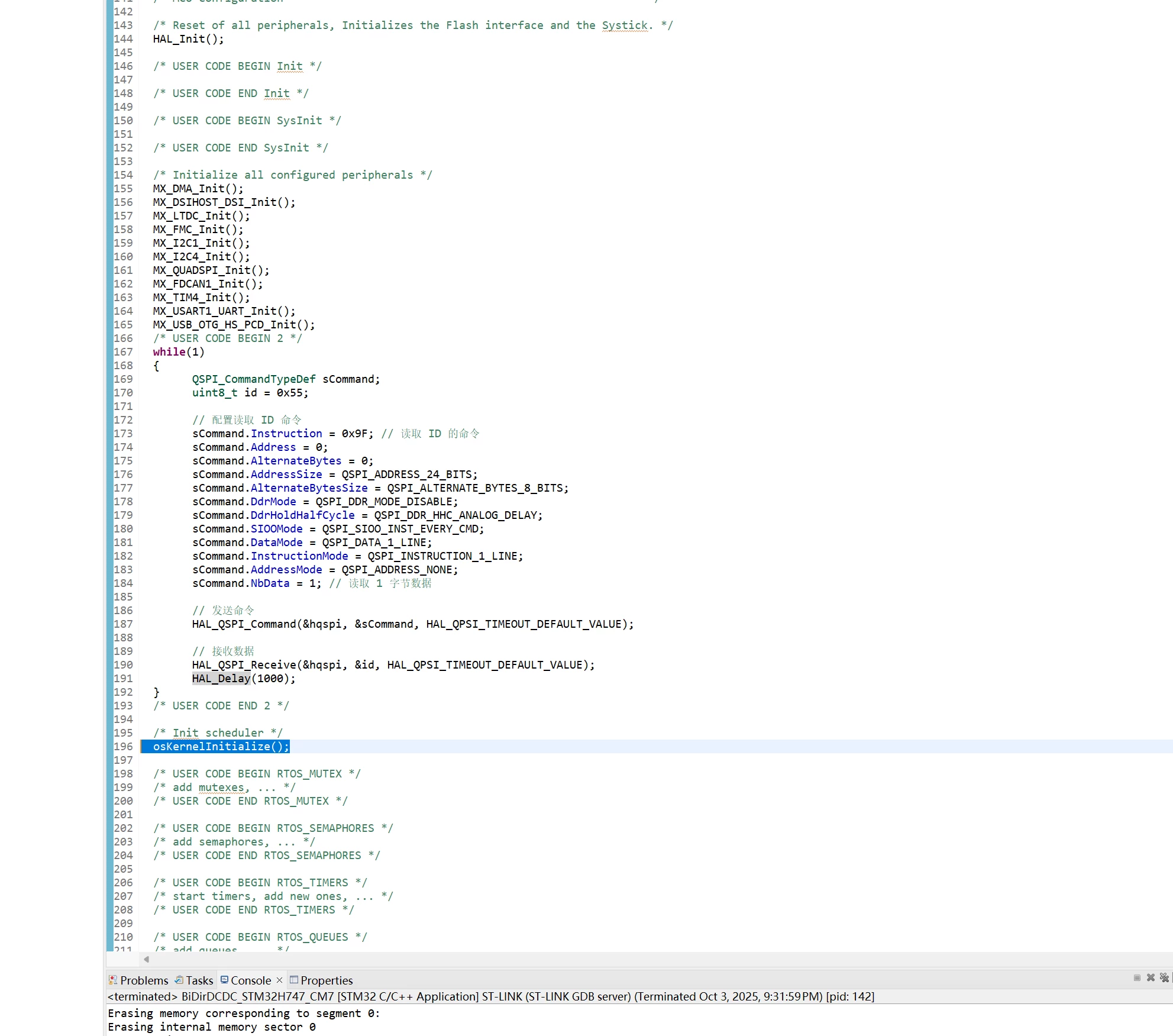

1、When I Start QSPI Work in main function,The QSPI Will always work。QSPI work on CM4-Core。
source:

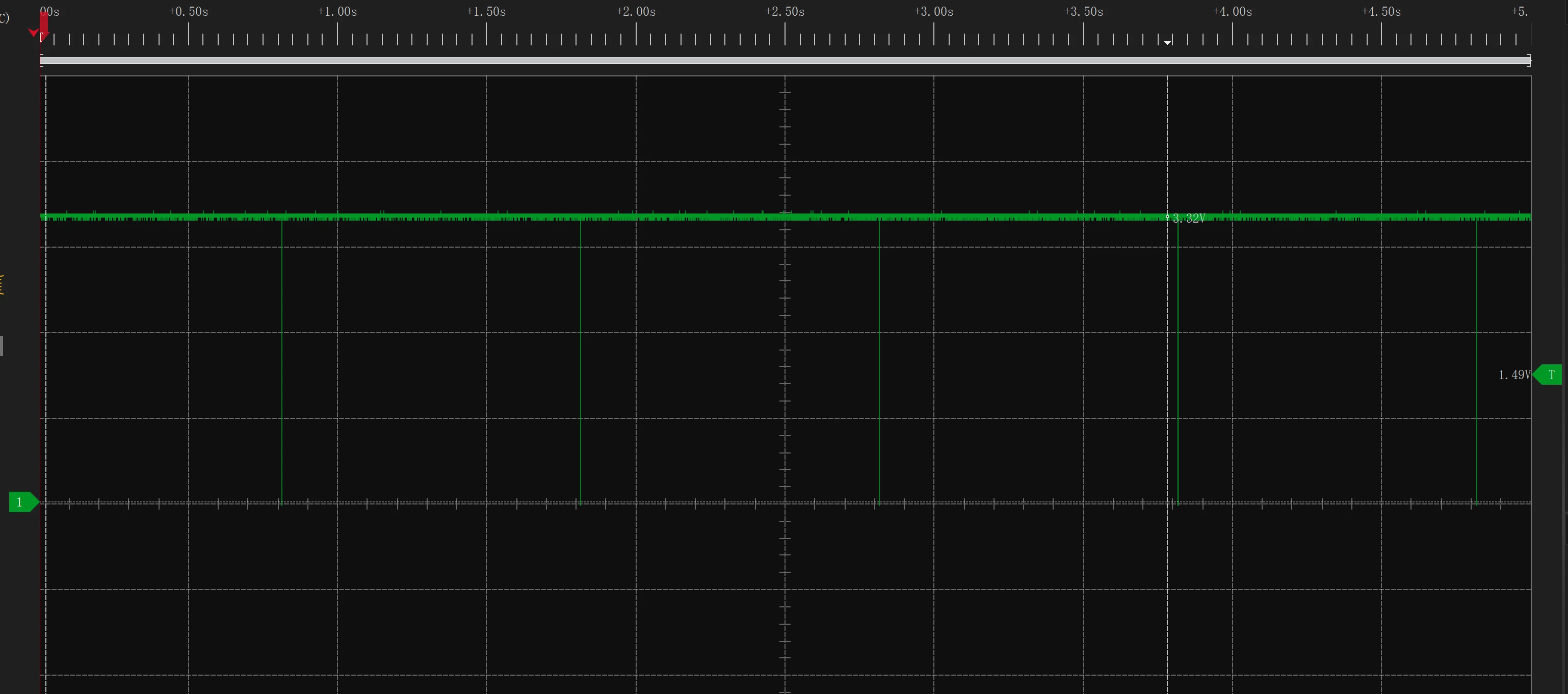

The QSPI CS signal wave,which Delta Time is 13us,not big than 1s according code:

After My Test,I Can Confirm:QSPI will work OK when before osKernelInitialize() and osThreadNew() function; Not Ok when QSPI work after osKernelInitialize() and osThreadNew() function, also not ok when work in thread.
The below figure, is CSn signal, period is 1s, matched The code function
