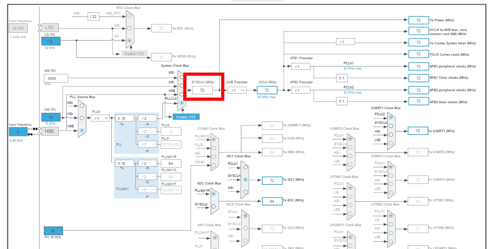

I can see the SysTick_Handler(void) has been generated by CubeMx. Could you please help/explain the following:
- I assume SysTick is the same as (i.e. the period of) the SysClk which in the diagram below (highlighted in red) is currently set to 72MHz, is that correct?
- That SysClk goes (only) to "To Power" and could not find any information as to what that is, so I don't know if changing that value changes other things in my code or generally in the micro configuration. What is that "To Power"?
- how do I set its time period (for example to 1ms) at runtime?
Thank you

The systick is used for system jobs, like hal-delay, and you should not touch or modify it.
But you can use the 1ms interrupt and do something there.
The timer for this system clock is part of the ARM core, so read in arm documentation about the core and it's modules, like debug unit or system timer.
You cannot use it for any pwm generation or so, it's just a timer for the system (in windows or Linux system you also have this,1ms system clock...), so use any timer of the many you have available, to do the modulated frequency generator
