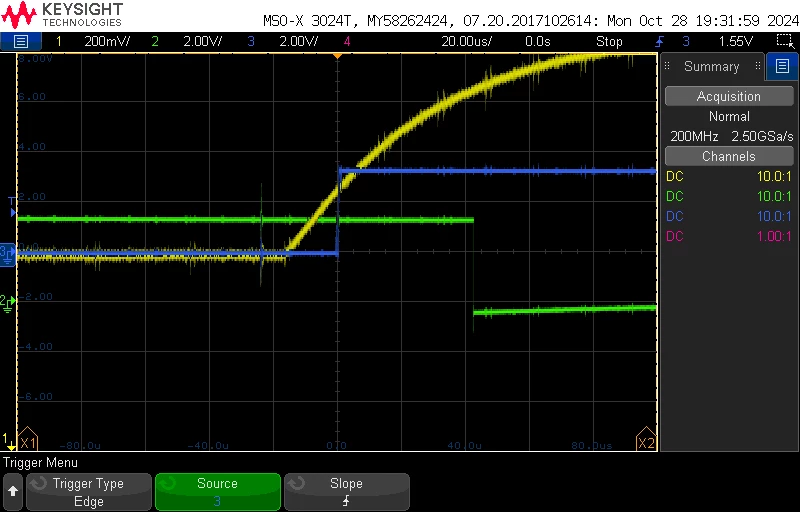

 Hi im using stm32g474vet6 mcu , in that im using internal comparator for PWM SHUTDOWN for protection purpose.
im using comp4. comp4 input pin is directly shorted to ADC pin and reference voltage is giving using DAC.
in the below attached image
yellow color : sudden change in adc signal which is going to comparator input.
blue color  : comparator output is taken out using gpio of mcu
green color : pwm signal from mcu.
in that image u can see that the sudden change in adc crosses the threshold value of comparator, and comparator output is become high , during that time pwm signal is not stoping exactly , it is shutdown at after the completion of that ON cycle, where as in pwm OFF cycle this is not happening pwm is shutting down fastly.'

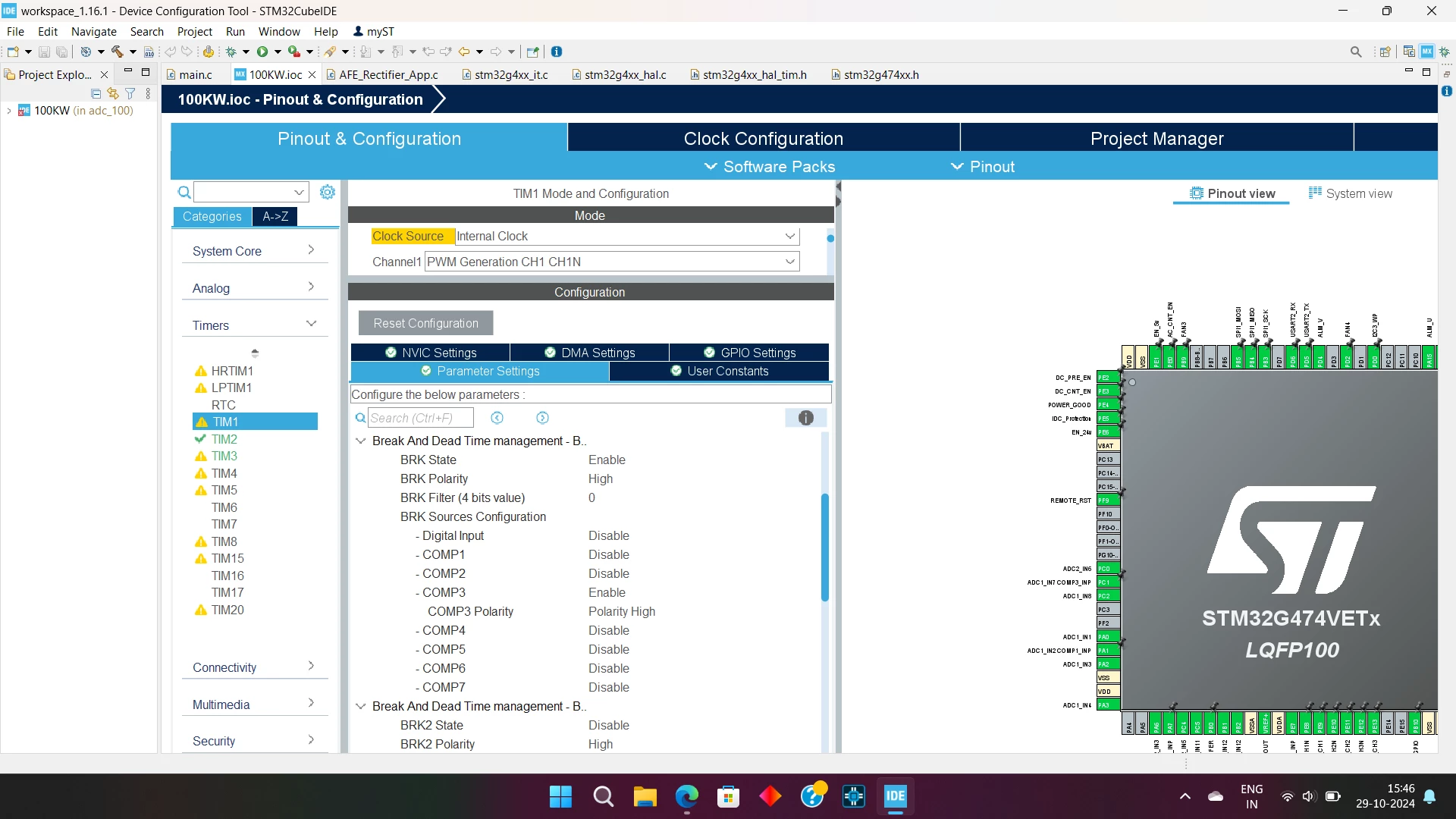

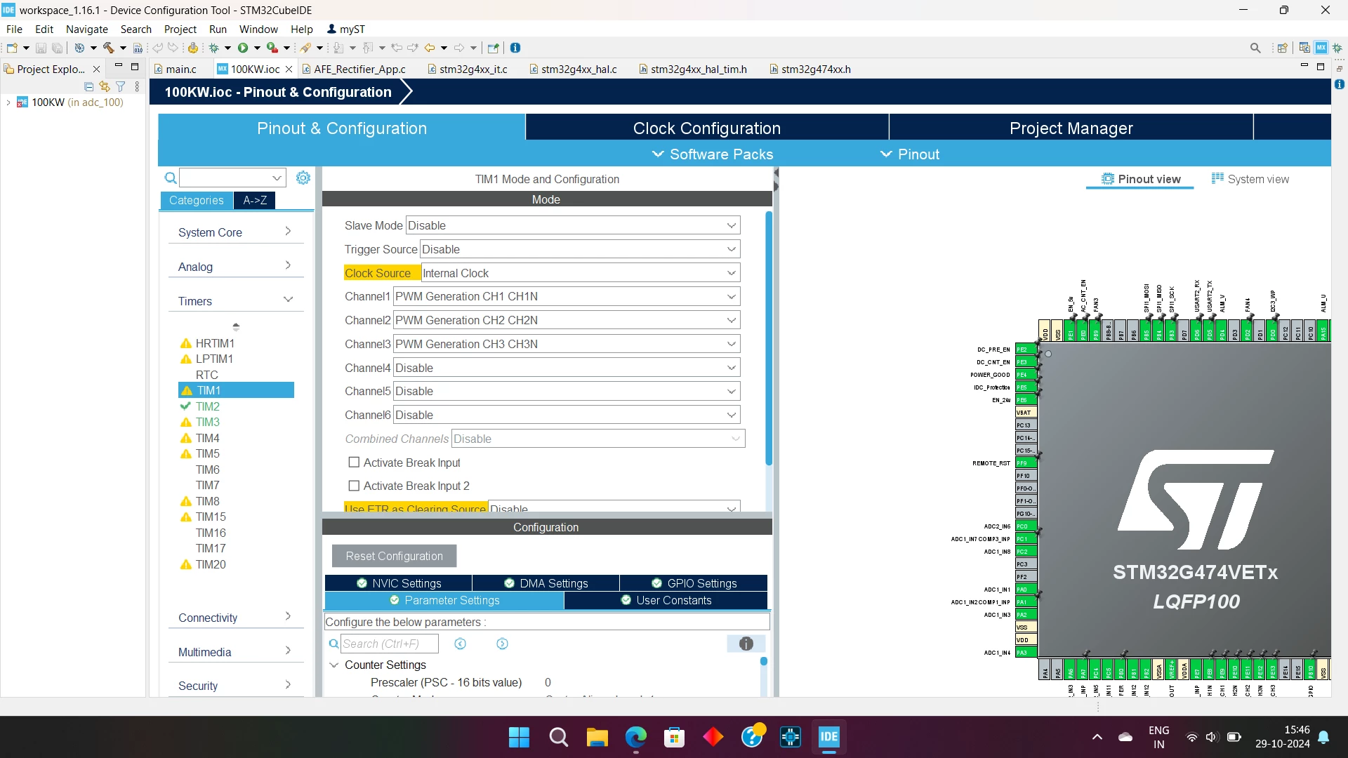

Oct 29, 2024 10:21 AM UTC
thank you for that note,
but im configuring in stm32 ioc file in that what settings i have to enable to shutdown the pwm fastly when comparator reaches its threshold,
any way im using
__HAL_TIM_CLEAR_FLAG(&htim1,TIM_FLAG_BREAK);
__HAL_TIM_MOE_ENABLE(&htim1);
to enable the pwm signal again after clearing the comparator fault.
please find the below images for settings done in ioc file
comparator works fine and pwm shutting down , i want to happen it fastly
could u please suggest any solution
