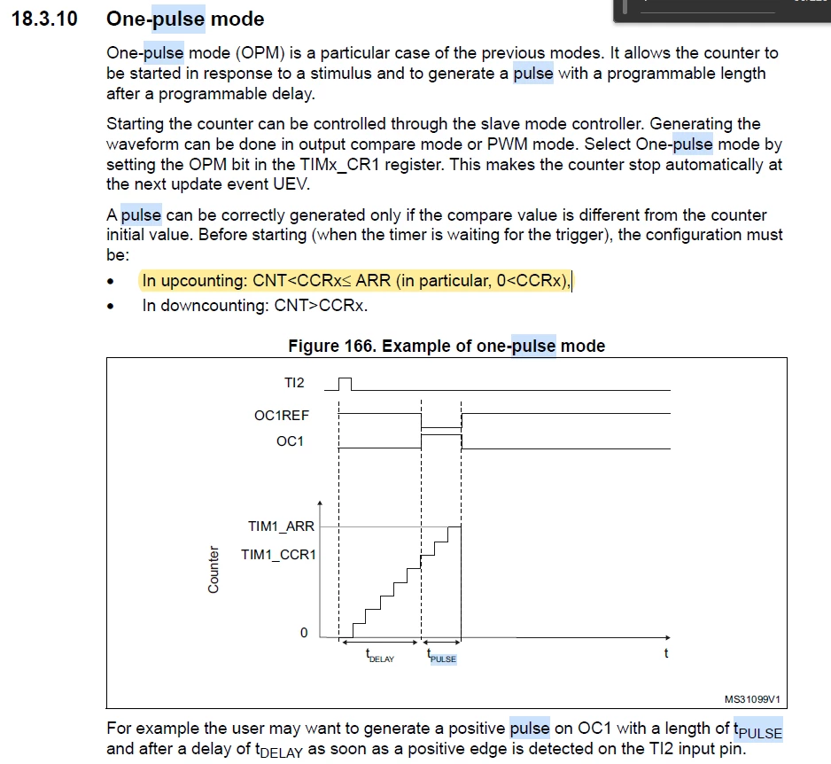

Since I want to be able to change the pulse parameter dynamically without having to set it every time by opening the .ioc file ... I decided in the main.c to directly change the register responsible for the Pulse parameter. So in the Reference Manual I looked up what it was and I found "one pulse mode" (in the attached reference manual, see section 18.3.10). I have read it several times but I can't figure out which register stores the Pulse value of TIMER4.

It's not written as "pulse" anywhere in the reference manual except in the OPM section since it is a single pulse there. That is an STM32CubeMX term (same with Period).

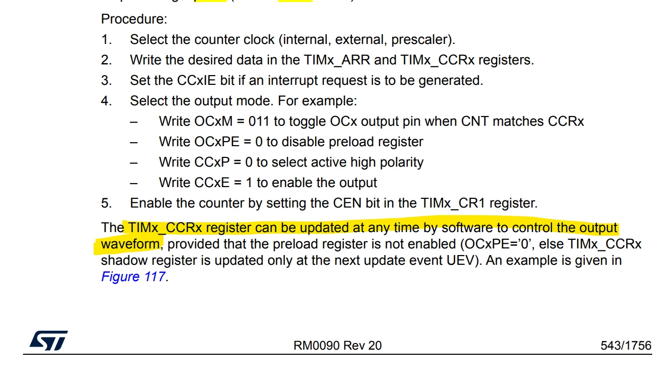

The RM says you can modify CCRx to adjust the waveform in a number of areas. For example, here:

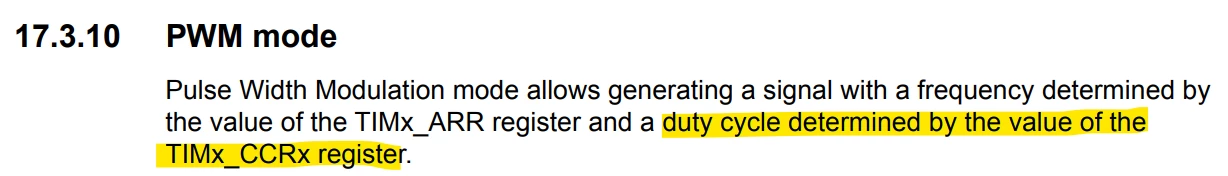

and here:

Check which timer channel (output) is used in your application. CCx controls TIMyCHx output, so if you use Channel 3 - CCR3 is the right register to set the pulse width.

"CCx controls TIMyCHx output" where is this written?
I am using CH3 so it is CCR3, logically I thought so too, however I would like to find it written in the reference manual
and here:
