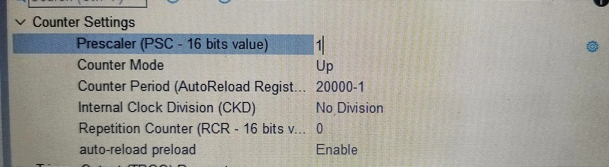

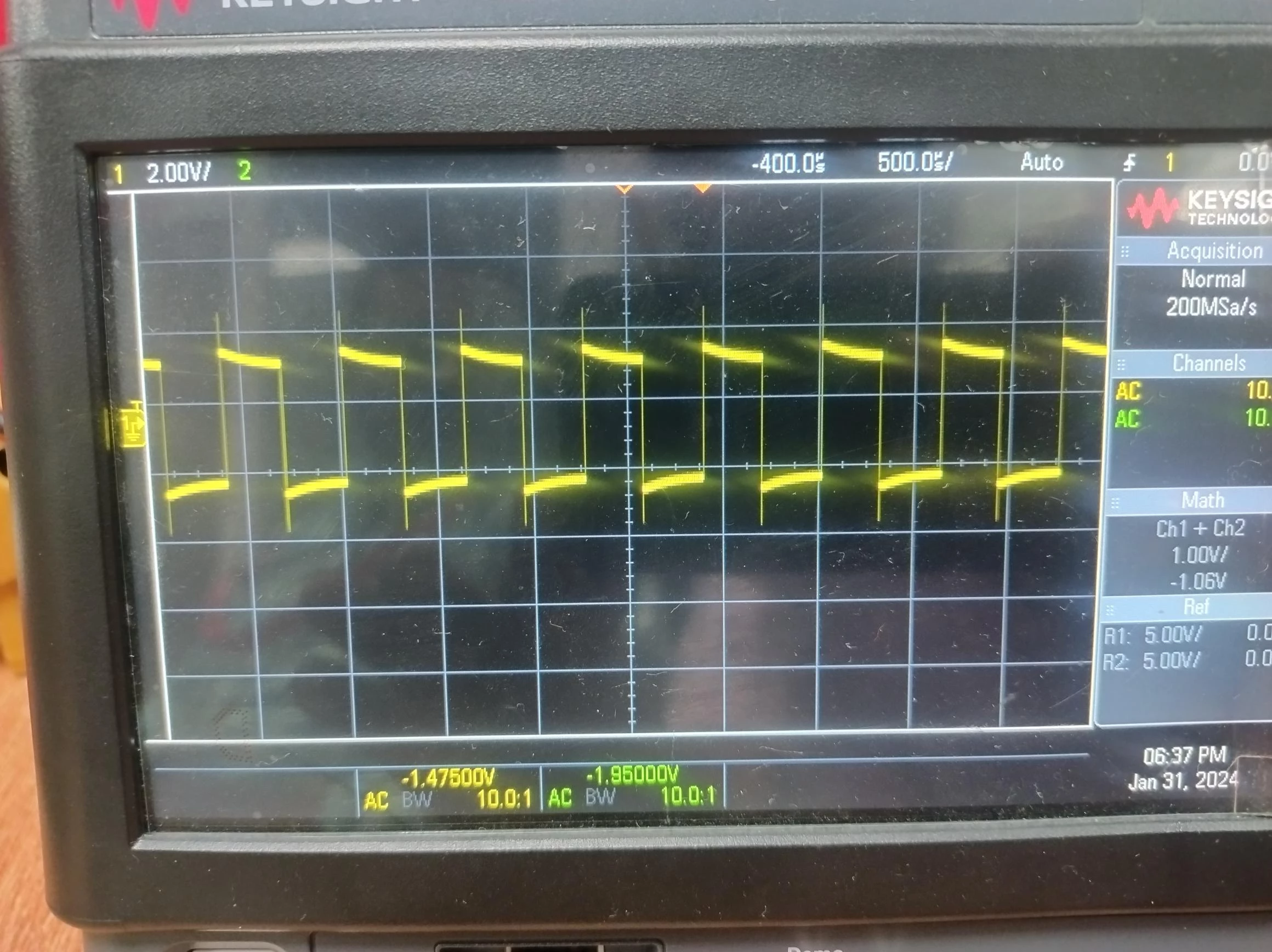

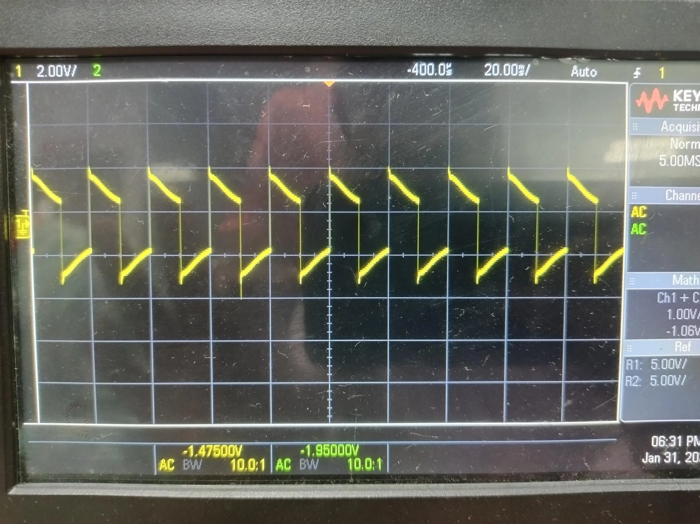

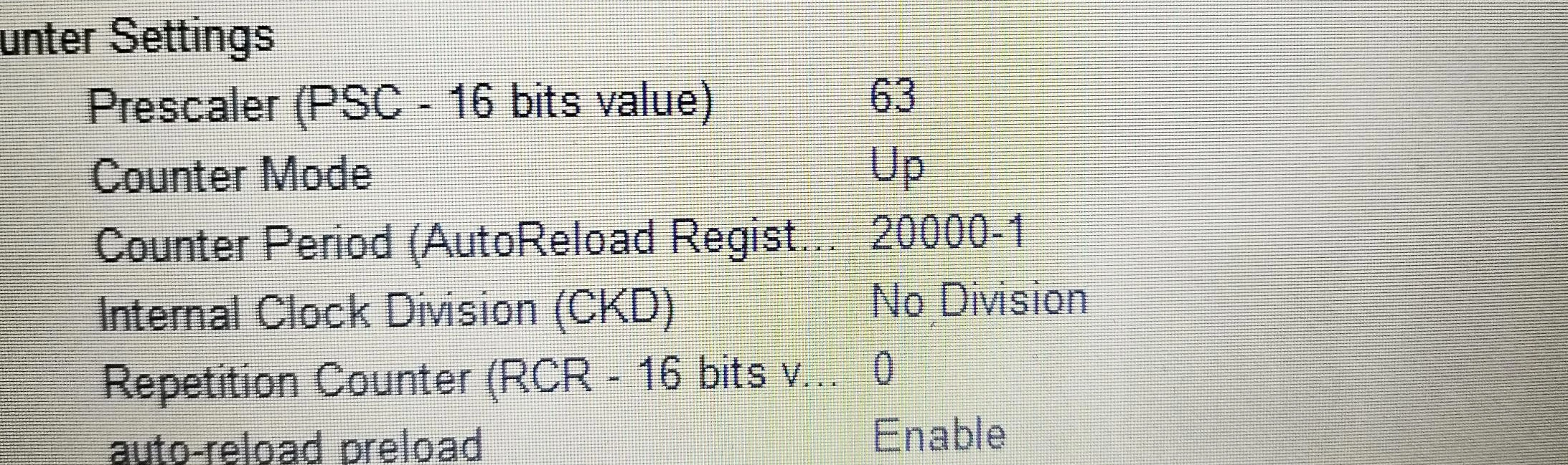

we are using STM32H7A3ZIT6 controller, in that for the PWM generation configured Advanced Timer 1 with the below configuration and we are getting the PWM wave like below pic. But we need exact square wave PWM.
can you please help to resolve this issue, and can you suggest what kind of parameter we need to configure?
we configure presale value as 63:
we configure presale value as 1:

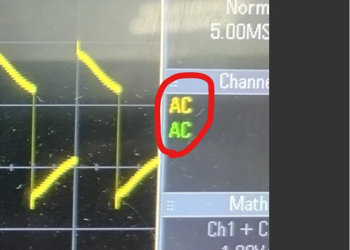

Jan 31, 2024 2:19 PM UTC
Your scope settings show the channel is AC coupled. Set it to DC coupled instead.
The PWM signal is most likely just fine.
