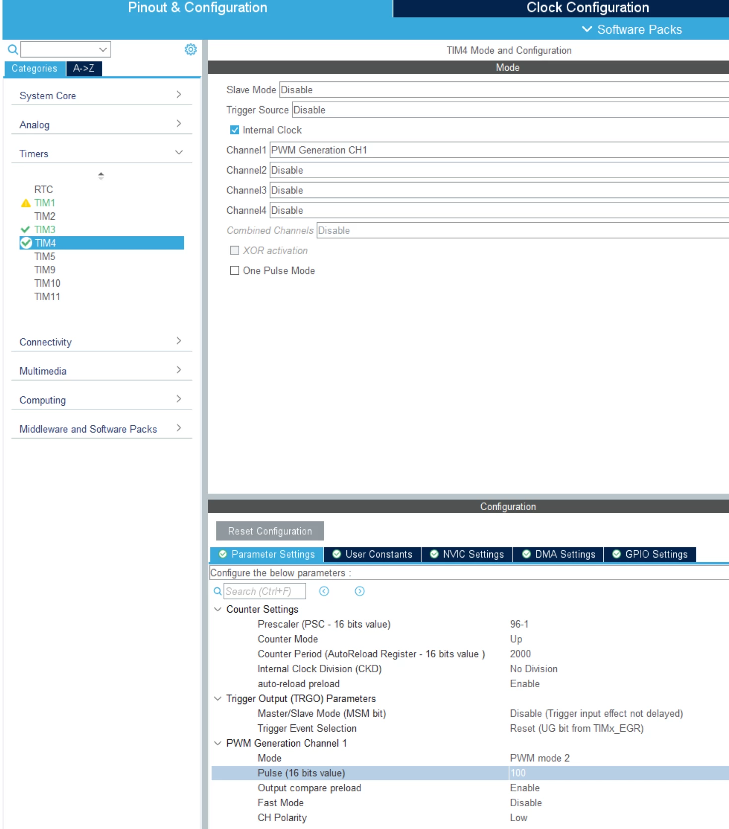

The problem is as follows: I need to generate a PWM signal that changes the period (not the duty cycle) with each iteration. (MCU: STM32F411)
I'm setting up the timer to use a PWM output on channel 1:

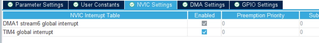

Global interrupts are also active:

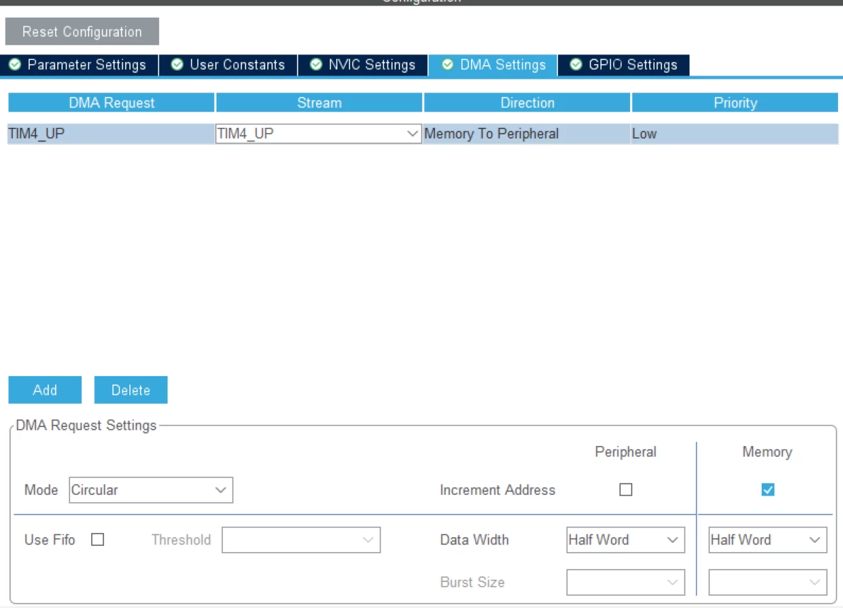

Then the DMA will be configured to update the ARR register:

u32FreqUpdate, that sounds as an array of 32-bit words; yet you've set the DMA to transfer 16-bit halfwords.
As the the first word in that array is 2000, its upper halfword is 0; DMA transfers that 0 into ARR which stops the timer. The 3 "successful" periods are due to ARR being preloaded (i.e. the first two periods are given by the initial setup) and the one nonzero halfword being transferred.

You are my Hero!
Switch to uint16_t has resolved the issue.
