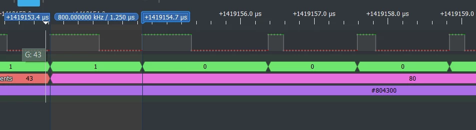

But for some reason I'm seeing a the strange, not correct, waveform
Am I doing something wrong?

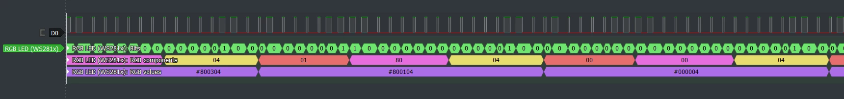

Expected waveform has a bunch of 1 and 0 encoding the LEDs colours for istance
Instead the one I previously upload has only zeros.
System clock is 48Mhz (HAL_RCC_GetSysClockFreq and HAL_RCC_GetPCLK1Freq both return 48M) so the period for each beat should be around 1,25us
For a '1' bit (PWM_HI = 38):
  • High time: ~0.79μs (38/60 × 1.25μs)
  • Low time: ~0.46μs (22/60 × 1.25μs)
  • Total period: 1.25μs
For a '0' bit (PWM_LO = 19):
  • High time: ~0.40μs (19/60 × 1.25μs)
  • Low time: ~0.85μs (41/60 × 1.25μs)
but instead I'm seeing different periods. Below a working PWM generated by DMA

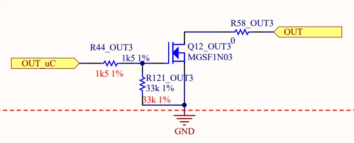

Could it be an issue on the MOSFET that actually drives the OUT and not the microcontroller output itself?
I'm currently attached to OUT, and not OUT_uC, and I'm unable to have a probe at the OUT_uC

Is there a pullup resisitor at the WS2812 input? The transisitor output is effectively open drain, so you need to enforce logic high state somehow.
