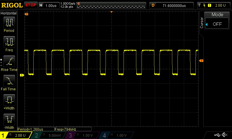

Hi all,
(I am using a STM32L031) I'm trying to design a system that receives a UART string and uses this data to drive a WS2812 LED strip at different colors depending on the string. So far, I've done a lot of googling and found that a lot of people are using HAL_TIM_PWM_Start_DMA() to vary duty cycles of PWM for similar purposes. I've done all the peripheral setup required I think and am able to get a PWM signal going (see attached .png) I have a couple of issues though - The PWM never stops even though HAL_TIM_PWM_Start_DMA() requires a length to be passed in. Now, I've checked that the DMA transfer completes, by setting a breakpoint in the IRQ handler like so:

Question 2: Now that I know that PWM is "working", how do I get it to stop completely after a single transfer occurs? As you can see, I have tried adding a HAL_TIM_PWM_Stop_DMA(...) in the if a transfer completes, but it has seemingly no affect. Or maybe it does, but HAL_TIM_PWM_Start_DMA(...) is called so soon after there is no perceptible pause. To fix this, I added a HAL_Delay(1000) in the interrupt handler (you can see I commented it out for now). Now the HAL user manual for the STM32L031 states that you need to be careful about using HAL_Delay when PWM is running, or in an interrupt. So I added this to give priority:

edit1: I was able to use HAL_Delay(...) within the interrupt by using
NVIC_SetPriority(DMA1_Channel1_IRQn, 1);
which I should have done initially. This now means that there is a delay between stopping and starting the DMA, however, my oscilloscope still shows that the PWM never stops. I find this odd...
edit2: I've managed to stop the PWM after completing one transaction: actually the while(1) loop isn't required at all. Instead I started the TIM_PWM_Start_DMA(...) outside of a loop, and then stopped it in the transfer complete interrupt. Probably I throw all of the logic inside of the interrupt and configure it to be at the lowest priority, which means it won't block anything else important

waclawek.jan
Oct 4, 2019 8:22 AM UTC
The basic thing is that timer is running and generating PWM infinitely, until you either stop it by writing 0 to TIMx_CR1.CEN, or by setting the timer to On-Pulse Mode, (but then you have to enable it after each period again).
The DMA just writes in the TIM registers upon triggers coming from the same TIM.
Perhaps read the related chapters in Reference Manual.

aaron1111
aaron1111Author
Oct 4, 2019 11:32 PM UTC
Hi JW,
Thanks for the reply, I've read the reference manual chapters on DMA, to be honest I didn't read the chapters on TIM - I managed to get the PWM to stop by writing HAL_TIM_PWM_Stop_DMA(...) in my transfer complete IRQ. Internally, this function calls __HAL_DMA_DISABLE which in turn disables the DMA. The only issue I have now is invoking the callback...
