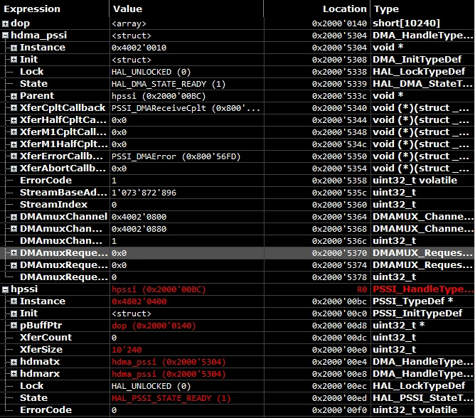

Here is a snap-shot of what I see:

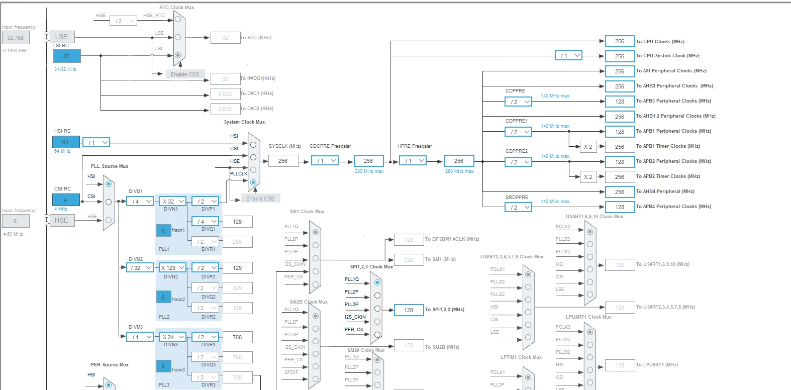

After receiving HAL_OK from HAL_PSSI_Receive_DMA(). I get the error interrupt with an error code of 0.  As may be seen, there is a DMA Transfer error.  This is running on the Nucleo-H7A3ZI-Q board.  The clock tree has been changed to increase the clock speed:

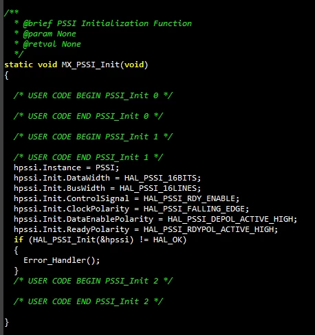

The PSSI setup:

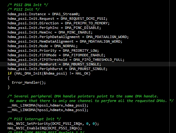

The DMA setup:
I’ve been studying the examples given on this board for both the H5 and the H7.  Whereas the N6 produced an immediate error response to multiple PSSI DMA attempts, the H7A does not.  The DMA controller fails on both.  What is preventing the DMA from working?
