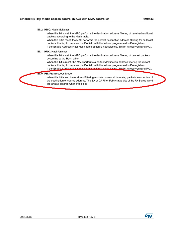

Hi
I want to use Promiscuous Mode with LWIP+STM32H743.
I want to be able to capture frames not sent over to my IP address.
Is it possible?
Thanks
waclawek.jan
waclawek.janBest answer
Jul 21, 2021 9:29 AM UTC
Yes, you have to use a hub, or a managed switch with properly configured port forwarding.
But this is entirely unrelated to STM32 or lwip.

waclawek.jan
Jul 14, 2021 12:33 PM UTC
0693W00000BdfZiQAJ.pngJW
deckhard
deckhardAuthor
Jul 14, 2021 12:57 PM UTC
Once that bit is set how do I capture the packets via LWIP?
waclawek.jan
Jul 14, 2021 5:25 PM UTC
I'm not interested in this particular problem; lwip is open source and has its own suport mail forum.
A quick look at the sources (lwip 1.4) shows that in ip.c:in_input(), addressed packets which are not addressed to us are considered for forwarding, if IP_FORWARD is defined. In lwip 2, things get muddier thanks to extensive ipv6 support, in ip4.c:ip4_input() I see the same pattern though. So, you may want to hook up your code somewhere there; or maybe even one level lower, at the packet driver level, just after reception.

To my understanding LWIP IP_FORWARD definition is for two NICs on the same board.
waclawek.jan
Jul 18, 2021 3:20 PM UTC
Yes. The intention of that code is, "if it's not for IP bound to this interface, it may be the other interface(s)".
What I said is, that that might be the place to splice in your code handling the unicast packets with not-own-IP.
deckhard
deckhardAuthor
Jul 21, 2021 6:41 AM UTC
While that might be a good idea, what about ARP reply? would the packets even get there if someone else's answered the ARP request?
waclawek.jan
