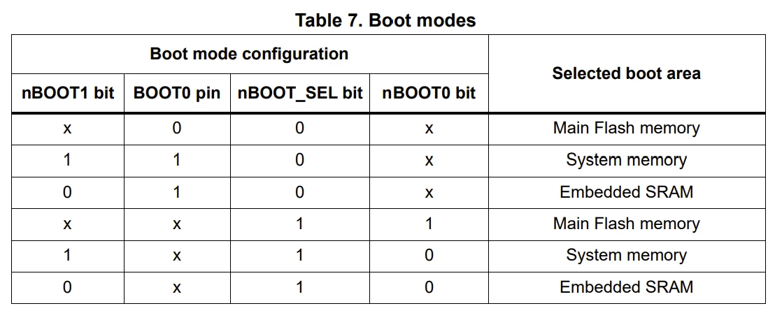

If I set nBOOT0_SEL bit to 1, nBOOT0 bit to 1 (boot from main flash memory and BOOT0 pin are not connect to boot mode), and remap SWDIO, SWCLK to reset state (SWD are disabled). I wonder is it possiable to program this chip again?
MM..1
Jan 22, 2022 2:38 PM UTC
Yes seems your blinky board have WTF setup from line 4.
Then you only can use SWD to get it back or replace chip on board with empty one.
SWD under reset is always work onle RDP level 2 i mean bloack it.
