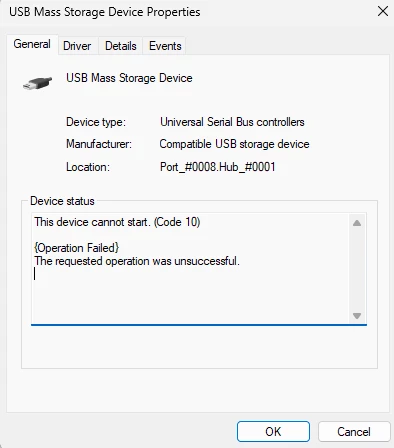

When using USBx, after some hours of digging around, I've managed to make windows recognize the device as a USB Mass Storage, but after some time (probably 20s) the device manager shows this:

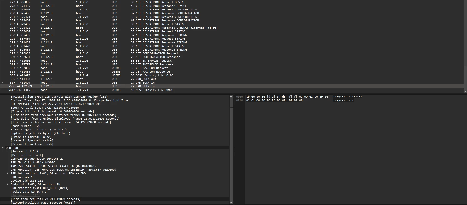

If I look at the USB frames in wireshark I see this:
The first descriptor response string appears to be malformed according to wireshark, but that doesn't seem to bother windows
The real problem seems to be in the SCSI Inquiry: it took the device 20s to reply to the frame number 307 (host -> device URB_BULK in).

I looked more into this and I think there might be a problem inside the stm32 USBx library (the function _ux_device_class_storage_inquiry hangs for 20 seconds), so I don't think there is a way to solve the issue on my side and I don't think I have the knowledge necessary to fix the library myself.
Is there any way to open an issue and a chance for it to be fixed, or should I look at TinyUSB?
