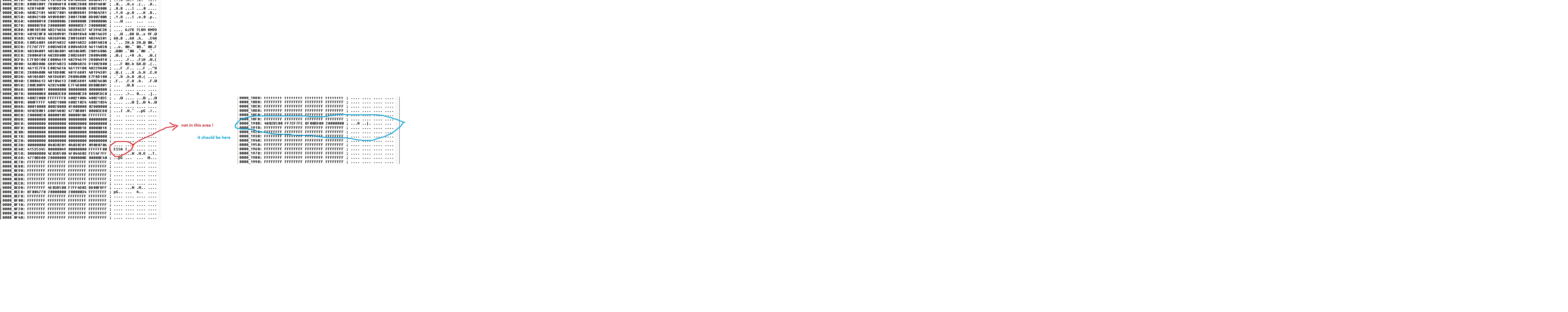

Hi
I'm using MikroC and try to play with Flash
My problem: even if area seem ok between "bootloader" and "program", I can see program area is not complete and is writed in bootloader area.
If you can help me ... thanks !
#pragma orgall 0xC0 /?
#define BOOTLOADER_START_ADDR 0xC0
#define START_PROGRAM_ADDR 0x1900
#define FLASH_SIZE_STM32F051K6U6 16000
#define FLASH_BACKUP_ADRESS ((FLASH_SIZE_STM32F051K6U6-START_PROGRAM_ADDR)/2)+0x1800
void main() org 0xC0 (bootloader)
 char x1=0;
 SetIOs();
 Led_Red
 UART1_Init(9600);
 Delay_100ms();
 if(x1)FLASH_MOVE(START_PROGRAM_ADDR,FLASH_BACKUP_ADRESS,FAUX); /
 if (0) //UART1_Write_Loop('g','r'))
 Start_Bootload(); // "r" recu -> start bootload
 else
 Start_Program();
void program org 0x1900 (after boot control)
 uart1_write_Text("ESSAI");
3 replies

Programming STM32 this way isnt good start. Ask on MicroC for ARM forums.
Or use STM32CubeIDE

MikroC exist for Pic & ARM (and some others)
I could use STM32Cube except it would need I modify many many files (I use MikroC from years) and I suppose it would take a long time to do so.
But could you explain me how to force routing positioning of the addressing in a compilation ?
