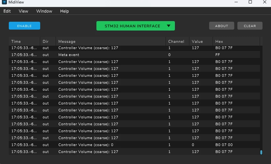

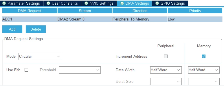

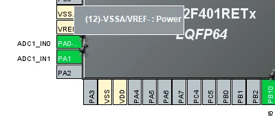

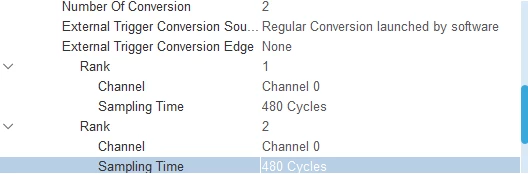

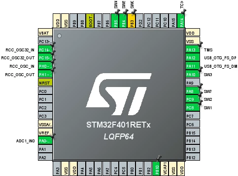

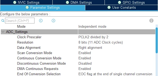

Problem with STM32F401RE as USB HID Device when using multi ADC with DMA
Hi!
Some time ago I did a post asking for a problem i had with this board used as a USB HID Device for a Midi Keyboard project when i wanted to read the value of a potentiometer with the ADC using DMA and send it as a Control Change command.
I solved the problem and i managed to send the control change command only when the knob is rotated, using only one channel and one potentiometer. (I'm also sending Note on and Note off commands with switches)

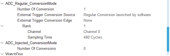

The configuration i used for only one channel that works is the following:
Spoiler
And this is the code (please note that it has a lot to improve still, i'm just testing everything works for now, but with only one channel it's working)

The problem comes when i tried to add another potentiometer using 2 channels the same way, the only difference in the configuration was adding another analog input and another channel:
Spoiler
And in the code i only changed the variable pot that i used as a buffer for the DMA to an array of 2 elements (pot[2])
The DMA initialization is the following:
HAL_ADC_Start_DMA(&hadc1, pot, 2);

It compiles OK and when i run it, i test it with a MIDI Monitor and the problem is that the potentiometer connected to Channel 0 (PA0) is sending Control Change all the time, and not just when i rotate the knob, and if i rotate nothing changes, and the second potentiometer seems to be doing nothing because the monitor only detects Channel 7 assigned to Channel 0
So i think i must have an issue with the configuration of the ADC or the DMA, or maybe an issue in the code i'm not seeing.
I hope someone can help me
Thank you
1 reply
pablin235Author
Aug 22, 2024 10:24 PM UTC
I just noticed I had the 2 channels configured as Channel 0 (as you can see in the picture i uploaded)
I changed that and now the 2 potentiometers sends differents values when moving the knob both the problem that sends all the time persists and it doesn't matter wich of the 2 potentiometers i move, the MIDI monitor always receive in MIDI channel 7 instead of MIDI channel 7 for one potentiometer (adc Channel 0) and MIDI channel 8 for the other potentiometer (adc Channel 1)
