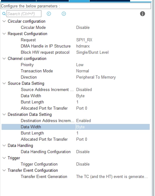

This is my DMA Setup:

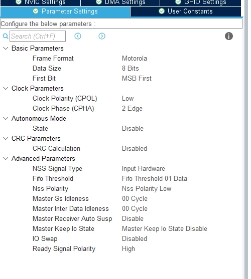

And this my SPI setup:
First of all, can you guys tell me whether my concept is valid? And if yes, do you guys have any idea why it doesn't work after two packets? I also attached the project files reduced to the bare minimum. The EXTI can be found in the _it.c file and the processing function in app_freertos.c.
