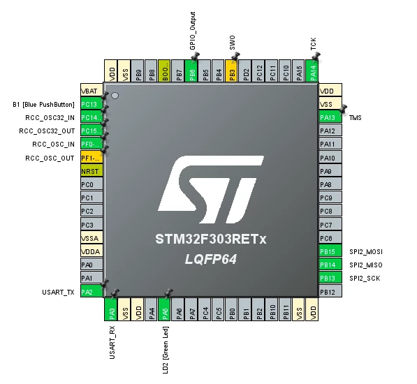

Hi, I’m having trouble reading measurements from the ADXL345 using SPI. I’ve attached a picture from the debugger that shows a view of the variables. The SPI is configured as master full duplex, and I’ve included a screenshot showing the SPI configuration. The SCK is connected to SCL, MISO to SDO, MOSI to SDA, and CS is connected to a configured output. I’m looking for help because I can’t figure out how to solve this issue.

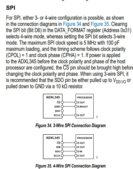

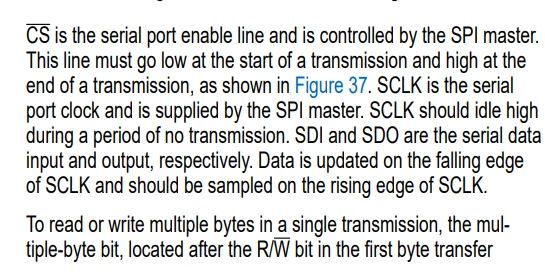

Nov 11, 2024 6:59 PM UTC
https://www.analog.com/media/en/technical-documentation/data-sheets/adxl345.pdf
As you can see in the attached debugger screenshot, the reading from the accelerometer — specifically, the X, Y, and Z position measurement from the data_rec buffer array — is incorrect. I don’t have an oscilloscope. I’ve shared images from the ADXL345 datasheet PDF; if you could kindly check whether it’s configured correctly, I’d appreciate it. I have attached the schematic of my microcontroller in a PDF, along with a screenshot. The connections are as follows: D13 to SCL, D12 to SDO, D11 to SDA, and D10 to CS.
Andrew Neil
Nov 11, 2024 7:22 PM UTC
Again, Can you successfully read the Device ID register ?
If you can't do that, then there's something fundamentally wrong with the comms - so no point worrying about X,Y,Z values!
