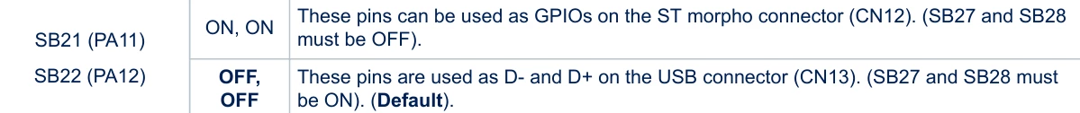

You should not short SB21 and SB22 as per UM3115
  • ON, ON These pins can be used as GPIOs on the ST morpho connector (CN12).  (SB27 and SB28 must be OFF).
  • OFF, OFF These pins are used as D- and D+ on the USB connector (CN13). (SB27 and SB28 must be ON). (Default).

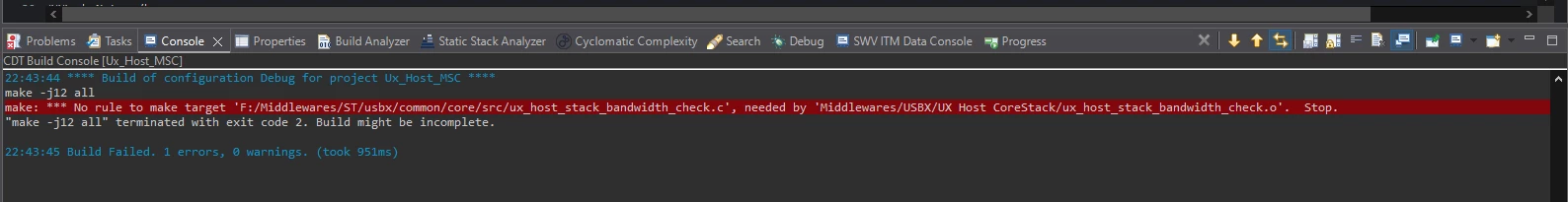

I have download the Source from mention link in last comment and i tried to compile it but it fails.

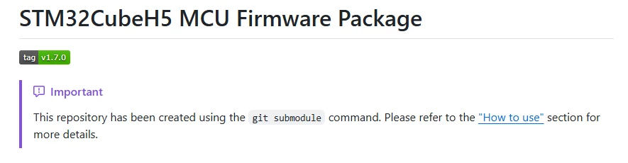

Sep 1, 2026 17:30 UTC
Did you follow the download instructions:
