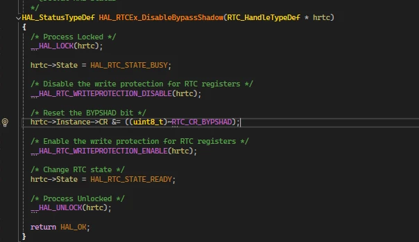

I see a problem in the HAL_RTCCEx_DisableBypassShadow function as the previous post POST advise, they convert the mas to uint8_t and by doing this when the value is and'ed the 24bit on the left are erased unintended.
Im using 1.16.0 of IDE and (STM32Cube MCU Package for STM32H7) 1.11.2

Hello @danirpg and welcome to the ST Community :smiling_face_with_smiling_eyes:.
Thank you for reporting this. I've escalated to the concerned team for correction on the coming version of the STM32CubeH7 (under internal ticket number 188682).
