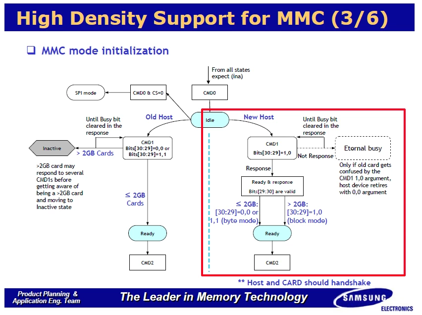

Gid Rid
February 9, 2017
Posted on February 09, 2017 at 16:05
Hi Nemui,
I have been trying your code and found that it doesn't correctly identify some eMMC cards. Assuming that all high capacity cards will be 'sector' access only is not a valid method to detect an MMC card greater than 2GB. eMMCs can have the CMD1 'SEND_OP_COND' response bit 30 set low as this indicates 'byte', not 'sector', access. The correct method is to check if the CSD C_size is set to 0xFFF.
HAL_SD_ErrorTypedef SD_PowerON(SD_HandleTypeDef *hsd)
/*!< Send CMD1 to receive the contents of the Operating Conditions Register */
if (response &= SD_HIGH_CAPACITY)
hsd->CardType = HIGH_CAPACITY_MMC_CARD;
else
hsd->CardType = MULTIMEDIA_CARD;
Regards,
Gideon
Nemui Trinomius
February 14, 2017
Posted on February 14, 2017 at 01:32
Dear Gid Rid,
Thanks for your notice.
Surely I was wrong in Block/Byte access detection on MMC/eMMC initialization.
Former code can miss-detect and assume to ''block'' addressing in spite of ''byte''.
Byte addressing 4GB MMC/eMMC cards applied this.
I already fixed this routine refer to Samsung's apprication note.
For detail,see attached png.
Best Regards,
