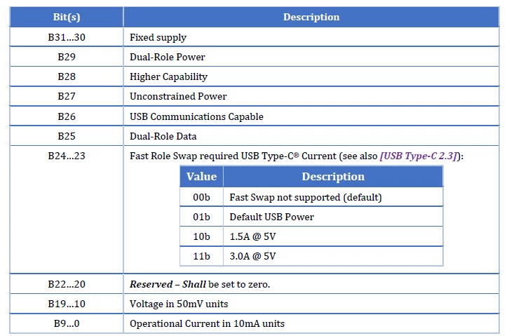

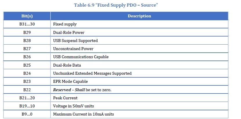

Jun 5, 2024 10:38 AM UTC
Hi @Marosh
SRC and SNK PDO are not built on same structure, so you cannot copy Received PDO from the SRC, into the SNK PDO of your equipement. Please check chapters 6.4.1.2 and 6.4.1.3 of Universal Serial Bus
Power Delivery Specification.
Example for Fixed PDO :
SRC structure :
SNK structure :
Regards

Jun 5, 2024 11:39 AM UTC
Hi @Guenael Cadiery,
Thank you very much for pointing out this issue. I have missed this difference. It seemed to me that it doesn't matter since defining the APDO in UCPD monitor yielded the same SNK APDO value as the SRC APDO when checking live expressions in the debugger.
So the step to do what I want would be extracting the type, voltage range and current from the SRC_PDO_List and using this together with the info from UM2552 (pdo def) to construct the SNK PDO. Is this correct approach?
