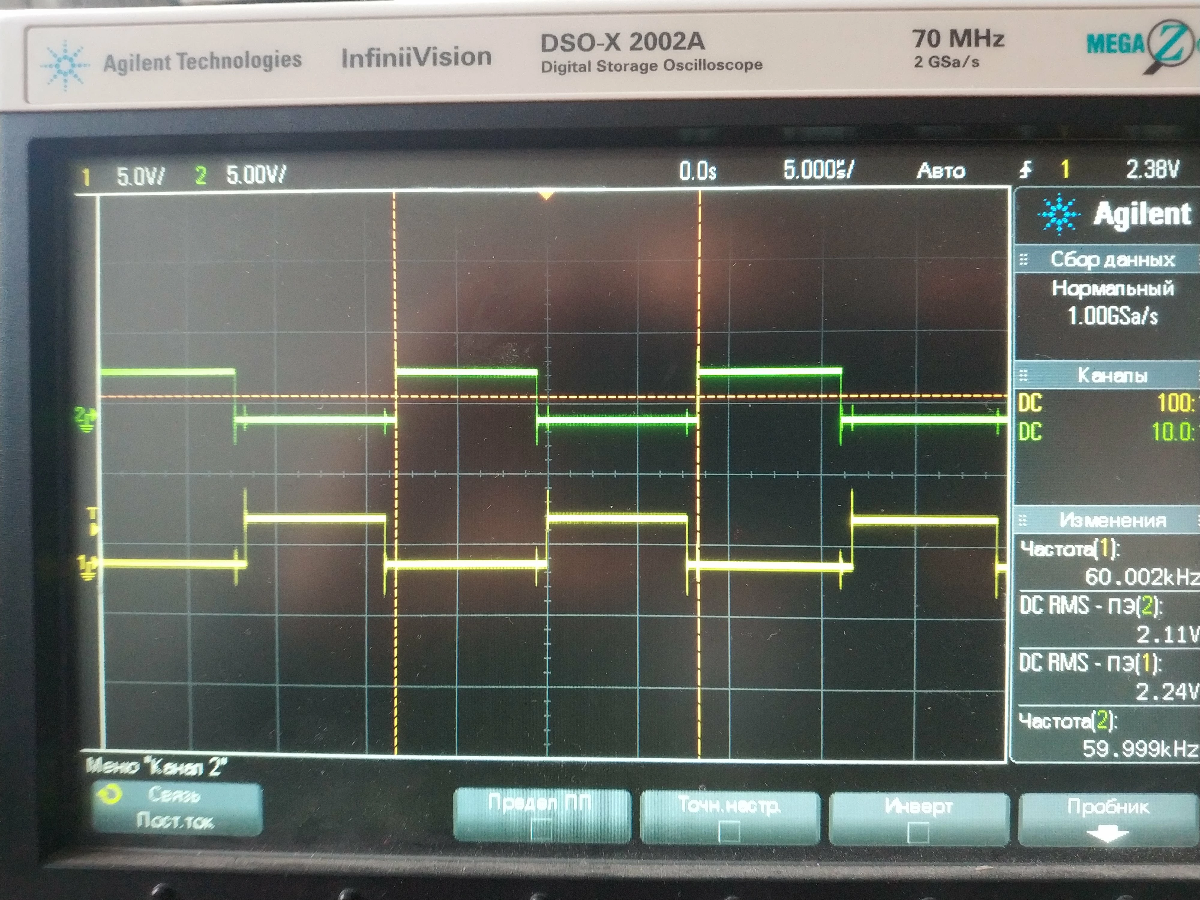

Problem using HRTIM with HAL on STM32F334
I have stucked trying to use hrtim pwm outputs on stm32f334r8.
I use initialisation provided by CubeMX to start all 10 channels right now. I use exactly the same setting for every channel, but still have different results.

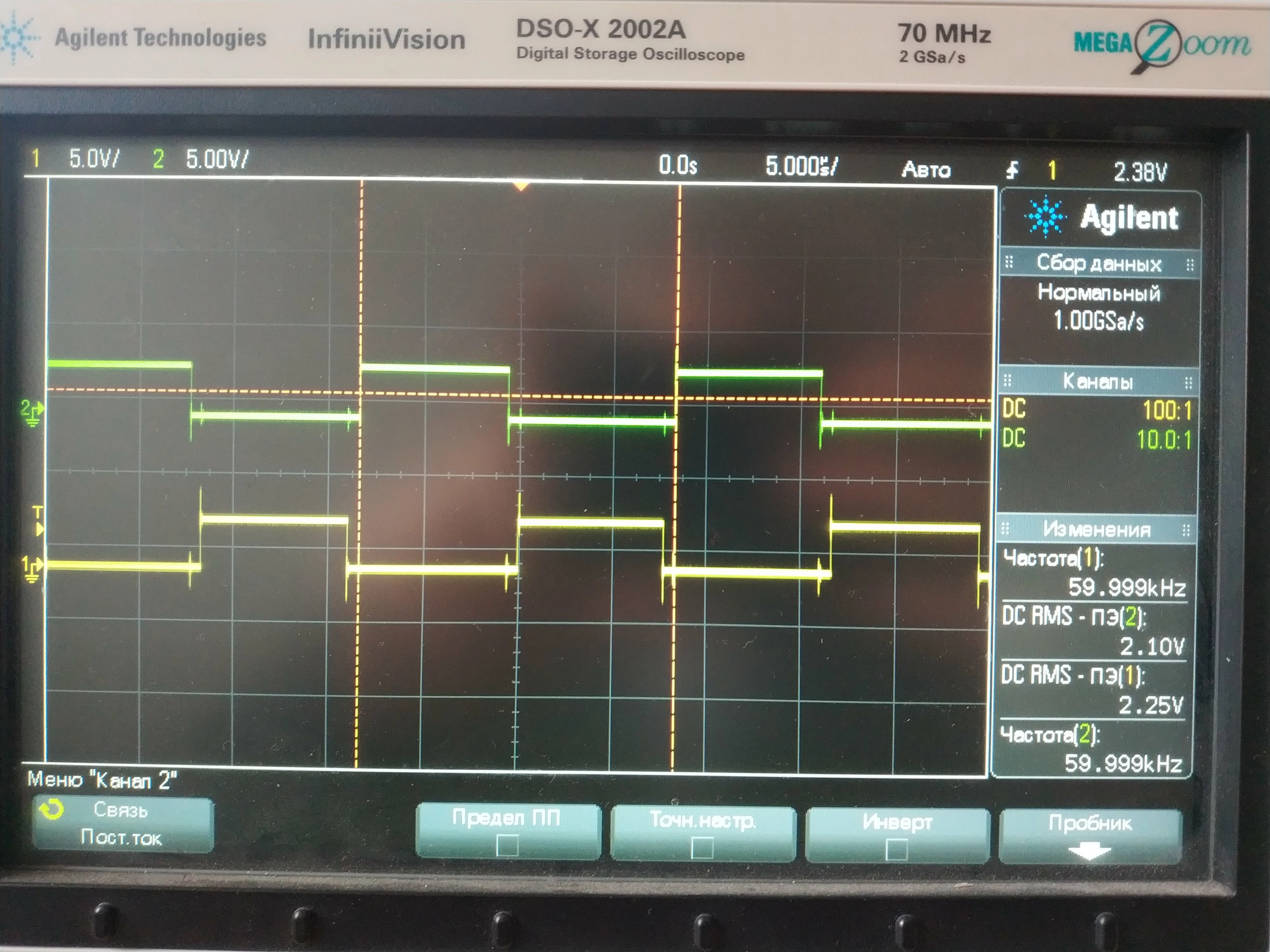

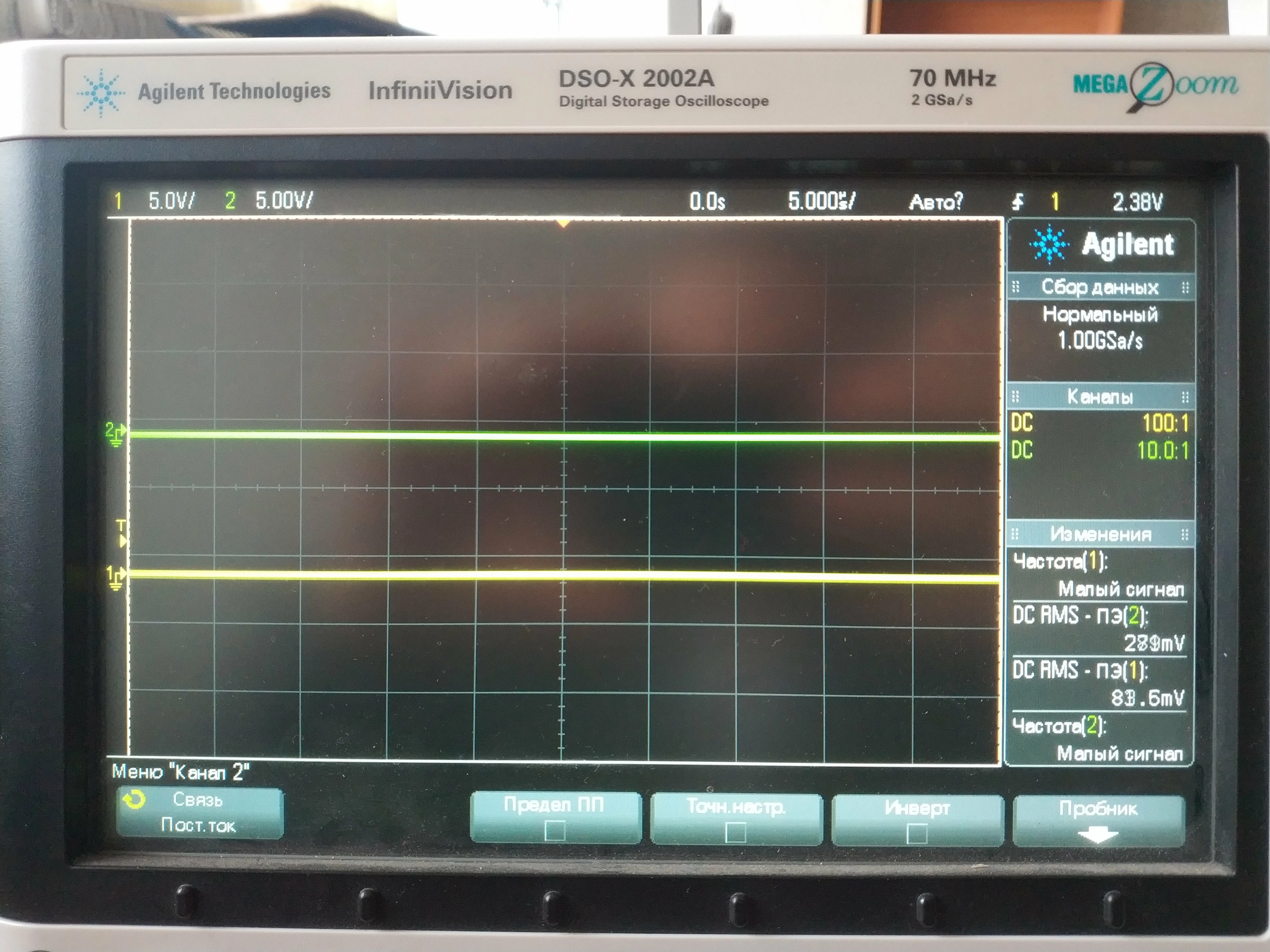

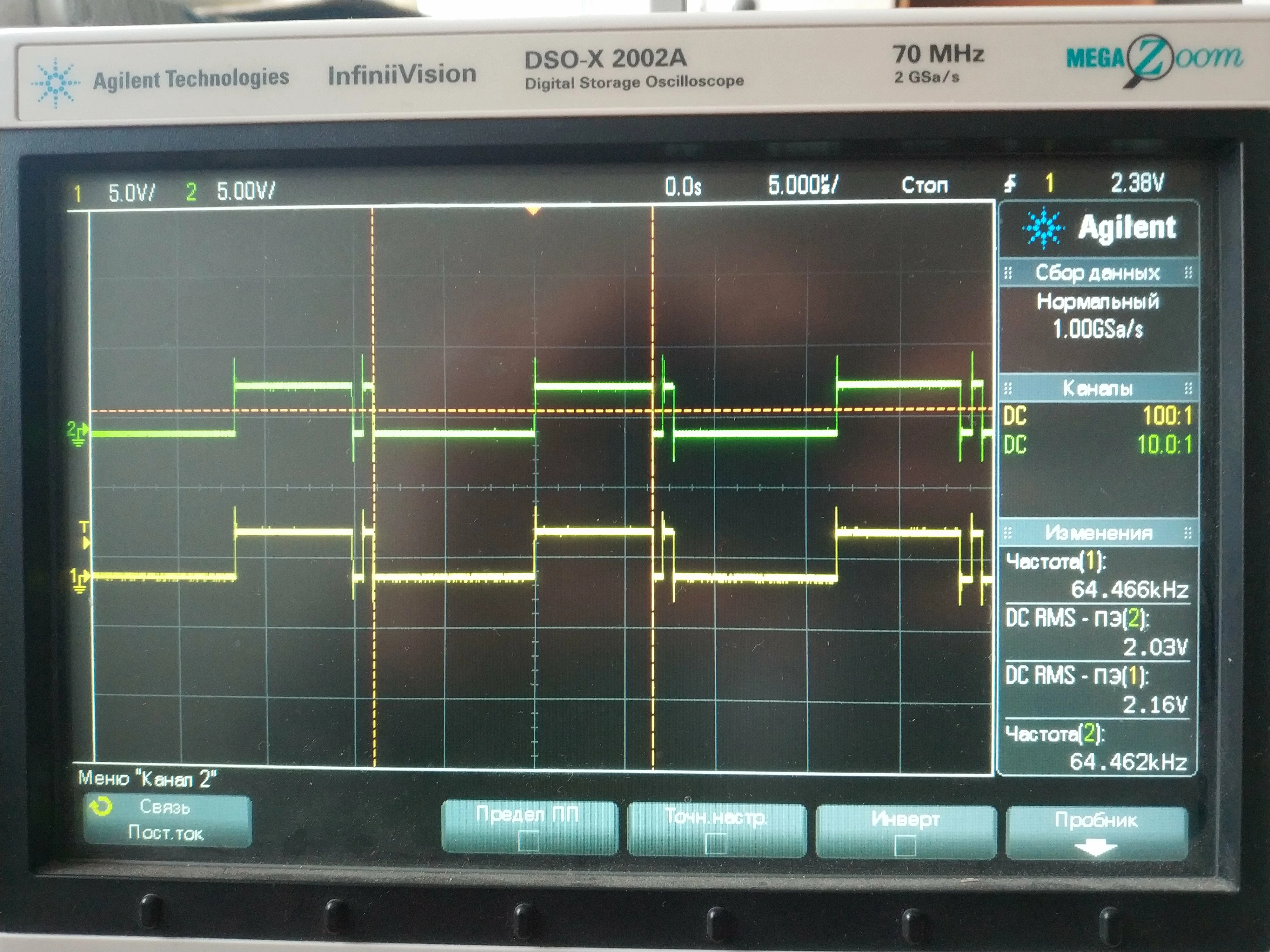

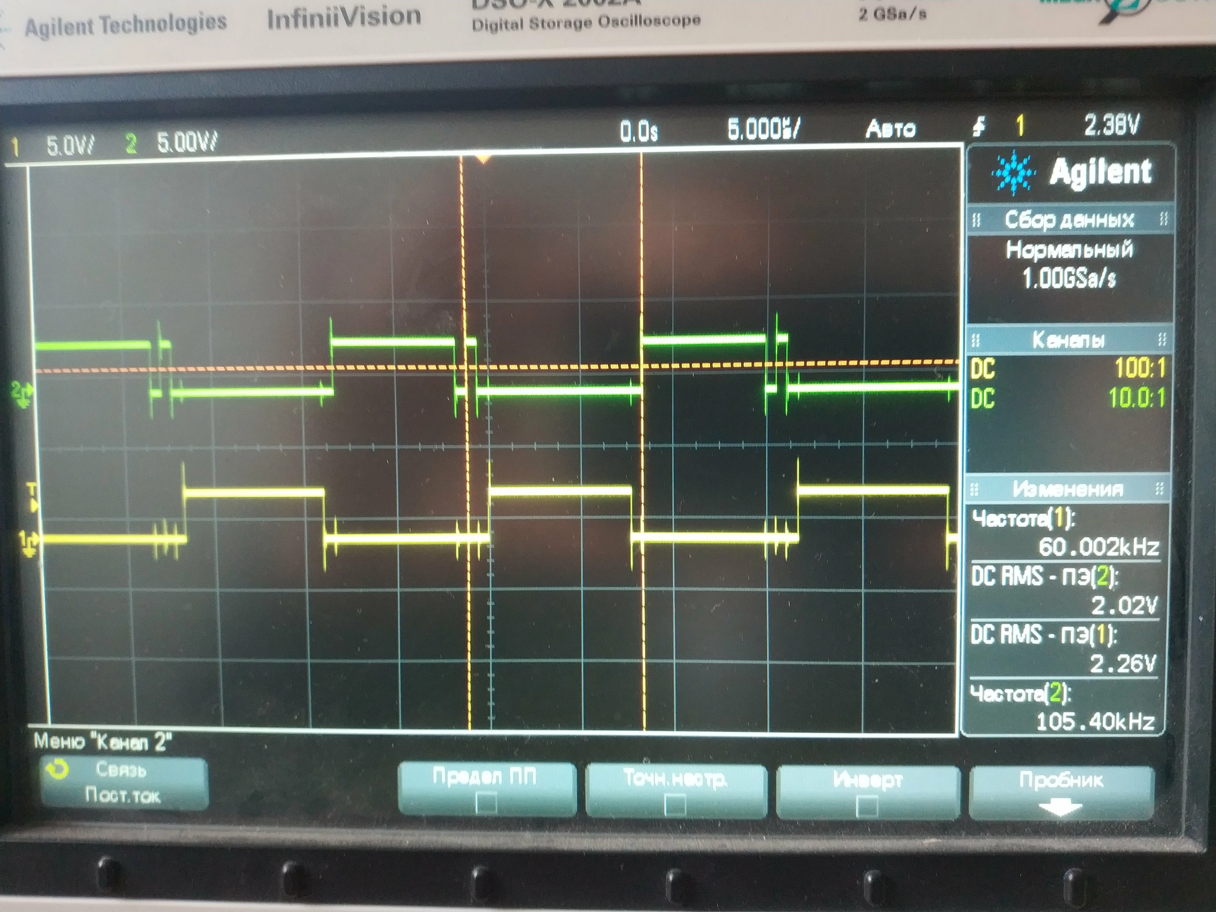

You can see the result on the images. Outputs A and E works great. Output B doesn't work at all. C has strange mistake - both outputs are the same, not opposite. C also has some problems with PWM, because of deadtime. D has same problems with pulses.
So the main question is simple as usual - what am i doing wrong here?)
UPD: Found another strange thing:
if I run all the timers, but start only pwm generation on A,D,E - I got nothing on TD1 while TD2 is working.

Rewrote hrtim code using registers. Found that problem with B channel was connected with Fault input pin, that wasn't initialized properly. Still haven't found what is wrong with C.

Sorry guys, my mistake. It looks like I have a hardware problem.
