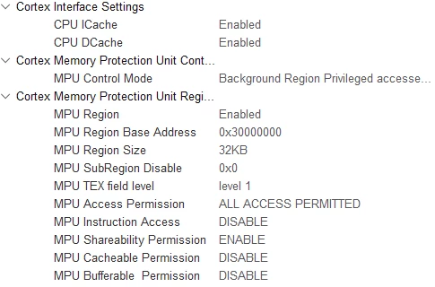

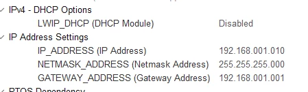

hi
I am using Nucleo-H743ZI2 for Ethernet :
Ethernet RMII:
First TxDescribter Address: 0x30000200.
First RxDescribter Address: 0x30000000.
Rx Buffers Length: 1536.
CortexM7 setup:
0693W00000UnbfTQAR.pngLWIP:
0693W00000UnbgCQAR.pngkey options:
0693W00000UnbgHQAR.pngLAN : Platform

but he when I ping the address I get :
ping 192.168.1.10
Pinging 192.168.1.10 with 32 bytes of data:
Reply from 192.168.1.37: Destination host unreachable.

1 reply
Pavel A.
October 8, 2022
Please always start from a ready example for this Nucleo, in the Cube software package or from github.
Do not use cube-generated stuff until you have a ready example working (whatever this means) as a reference.
Also, use a private ethernet network, avoid connecting the board to office network or internet while debugging.
