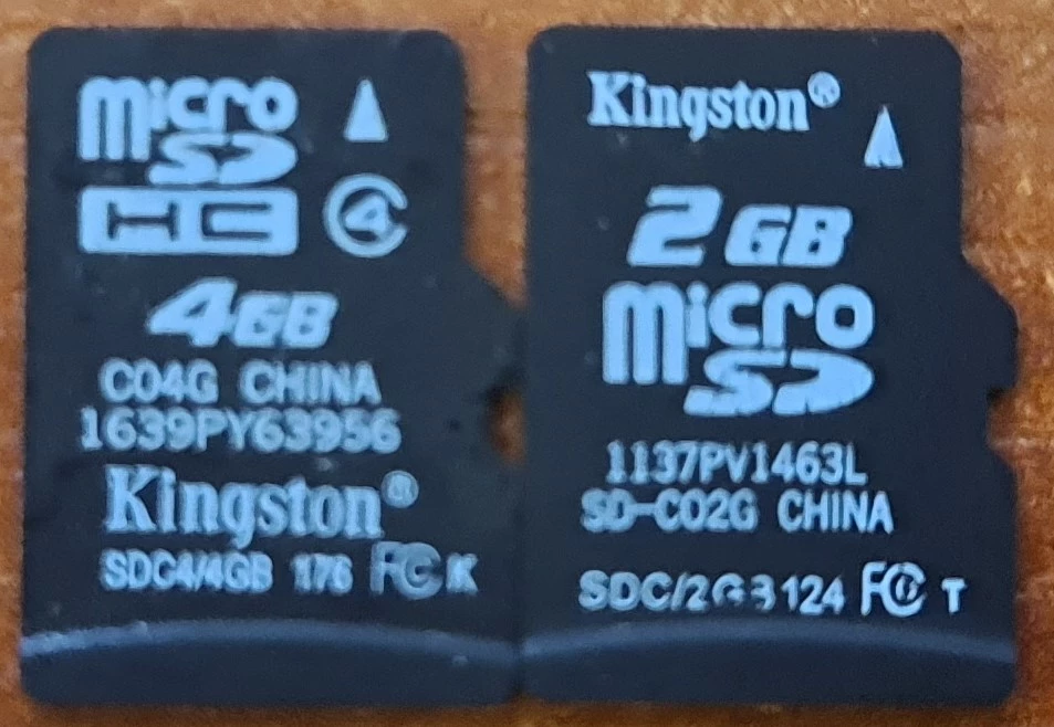

KMach.2
KMach.2Author
September 17, 2021
I tried it on two different cards. The first, target one is a 2GB kingston older one and the second one is a 4GB kingston SDHC. I don't know their parameters, but I specifically chose smaller/older cards. I formatted them properly to FAT format before using them.
