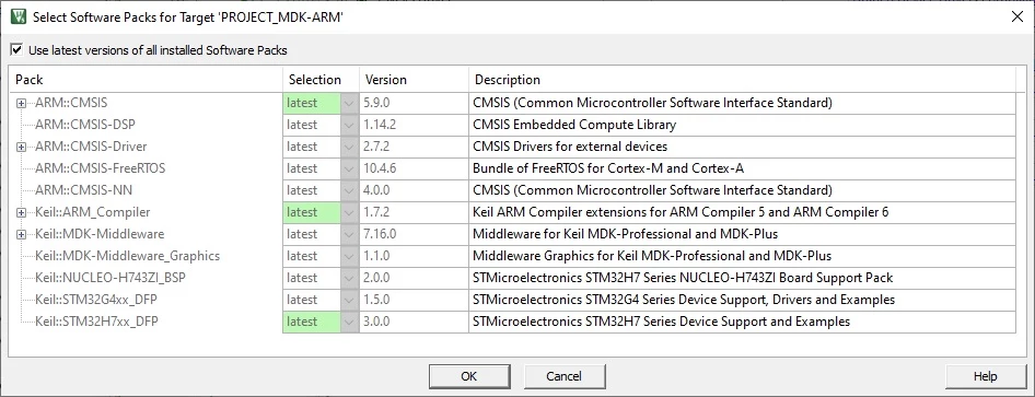

Hi STea,
here are the versions of the different software components used in the project
Additionally, I read another interesting post on this topic ([BUG] STM32 lwIP Ethernet driver Tx deadlock) which seems to match my problem.
