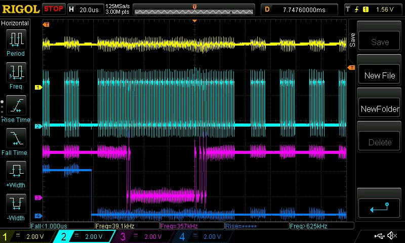

I'm trying to connect an sd card to the stm32f091cct6 microcontroller using FatFs driver. After sending some clock while MOSI and CS are high, I send idle command (CMD0) but receive no response from sd card. I pulled up MISO pin with a 100K resistor and clk pin with a 10K resistor. sd card isn't dead because I tried to communicate with it with another processor (TI ARM cortex M3) and it was a success. I pulled up all signals interally. (I tried different configurations of internal and external pull-ups but nothing happend). This is spi initialization code:

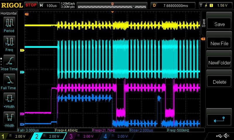

I've attached spi signals
yellow: MISO
cyan: CLK
purple: MOSI
blue: CS

Are you sure the SD Card accepts SPI mode? Have you tested it with a working example?

Seem to recall single bit mode was a prerequisite
