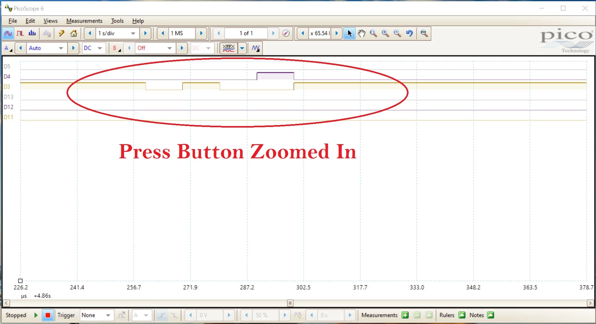

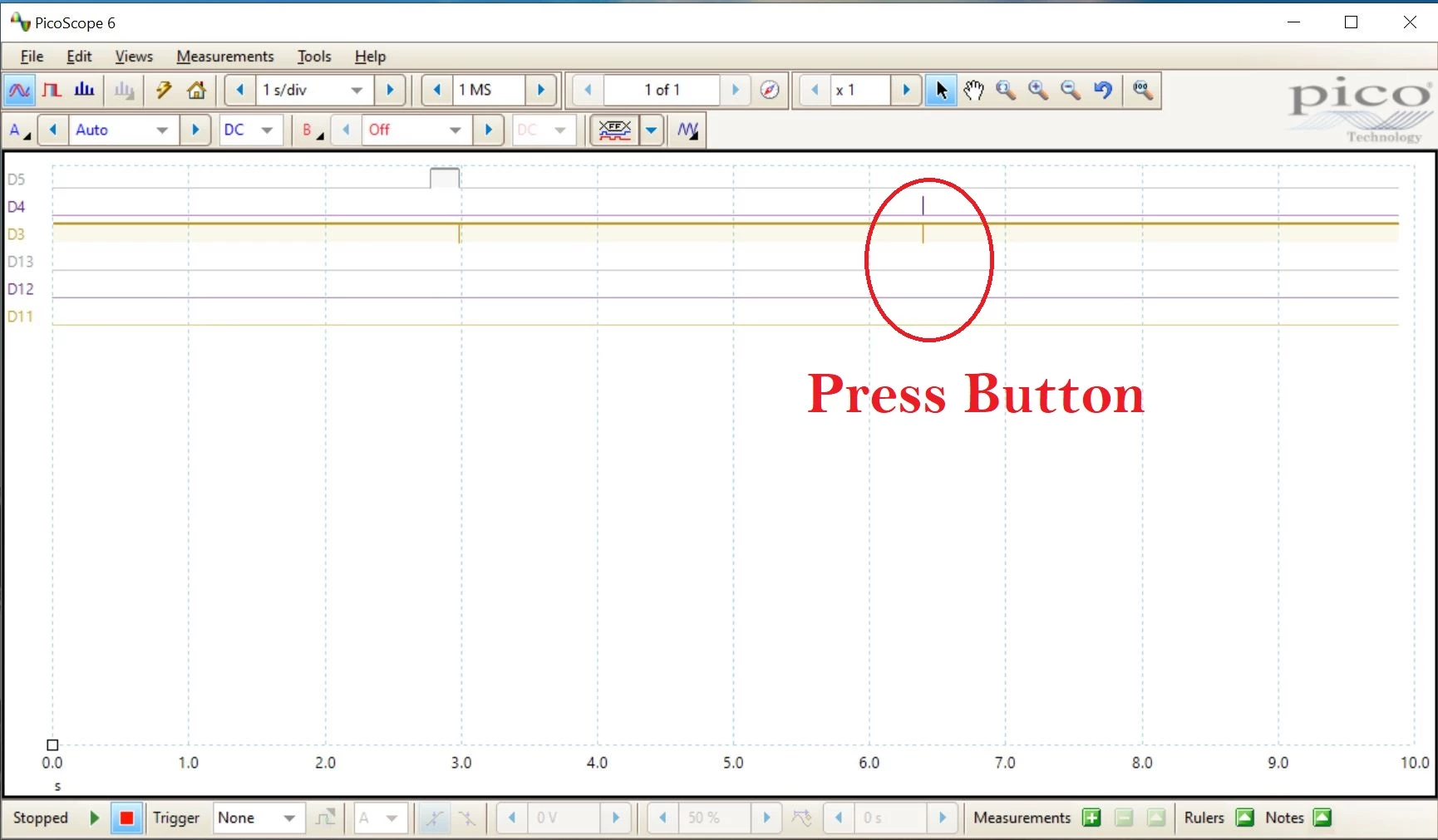

In the while loop, I keeps calling LL_DMA_EnableChannel, expecting to see repeated transmitting SPI message.
I used PicoScope to monitor SCLK and MOSI lines signal as showed below (D3 and D4). I expected repeated signals in those two lines, which did not happen. As showed in the picture below SPI transmission only happens once.
Another weird thing is that I define uint8_t aTxBuffer[] = {0x01, 0x02, 0x03, 0x04}; so I expect SPI to transmit 4 bytes out in MOSI line. What I captured is
 0693W00000DmFvZQAV.jpgD3 is clock and D4 is MOSI. Obviously, the signals are far off from what is expected.
