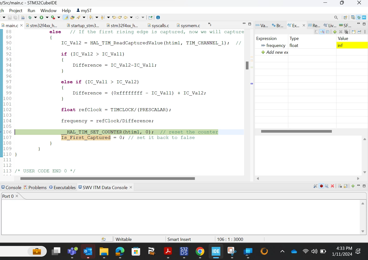

#define TIMCLOCK 84000000
#define PRESCALAR 84
uint32_t IC_Val1 = 0;
uint32_t IC_Val2 = 0;
uint32_t Difference = 0;
int Is_First_Captured = 0;
/* Measure Frequency */
float frequency = 0;
void HAL_TIM_IC_CaptureCallback(TIM_HandleTypeDef *htim)
	if (htim->Channel == HAL_TIM_ACTIVE_CHANNEL_1)
		if (Is_First_Captured==0) // if the first rising edge is not captured
			IC_Val1 = HAL_TIM_ReadCapturedValue(htim, TIM_CHANNEL_1); // read the first value
			Is_First_Captured = 1; // set the first captured as true
		else // If the first rising edge is captured, now we will capture the second edge
			IC_Val2 = HAL_TIM_ReadCapturedValue(htim, TIM_CHANNEL_1); // read second value
			if (IC_Val2 > IC_Val1)
				Difference = IC_Val2-IC_Val1;
			else if (IC_Val1 > IC_Val2)
				Difference = (0xffffffff - IC_Val1) + IC_Val2;
			float refClock = TIMCLOCK/(PRESCALAR);
			frequency = refClock/Difference;
			__HAL_TIM_SET_COUNTER(htim, 0); // reset the counter
			Is_First_Captured = 0; // set it back to false
What I receive:
The above code value of "IC_Val1" is not update,
because in that function (as shown upside), tempreg value is not read from CCR1 register and I can see '0' value I receive after callback function.
So, garbage value is print on consol.
What is expected output:
The expecting output is that value is read by function which we are gave by function generator via pin.
So updated value of that frequency variable.
So, my concern is that should I use other function in my IDE or should i change in function or my code(main.c file)?
Please, guide me.
And other thing is that should I put this function or not?
TIM1->CCR1 = 50;
HAL_TIM_PWM_Start(&htim1, TIM_CHANNEL_1);
HAL_TIM_IC_Start_IT(&htim2, TIM_CHANNEL_1);
in above three lines which are required for Input capture?

Perhaps go off of an existing example:
https://github.com/STMicroelectronics/STM32CubeF4/tree/master/Projects/STM32446E-Nucleo/Examples/TIM/TIM_PWMInput
What does your code do if IC_Val2 == IC_Val1?
Step through, set breakpoints, ensure clock is actually running, see
