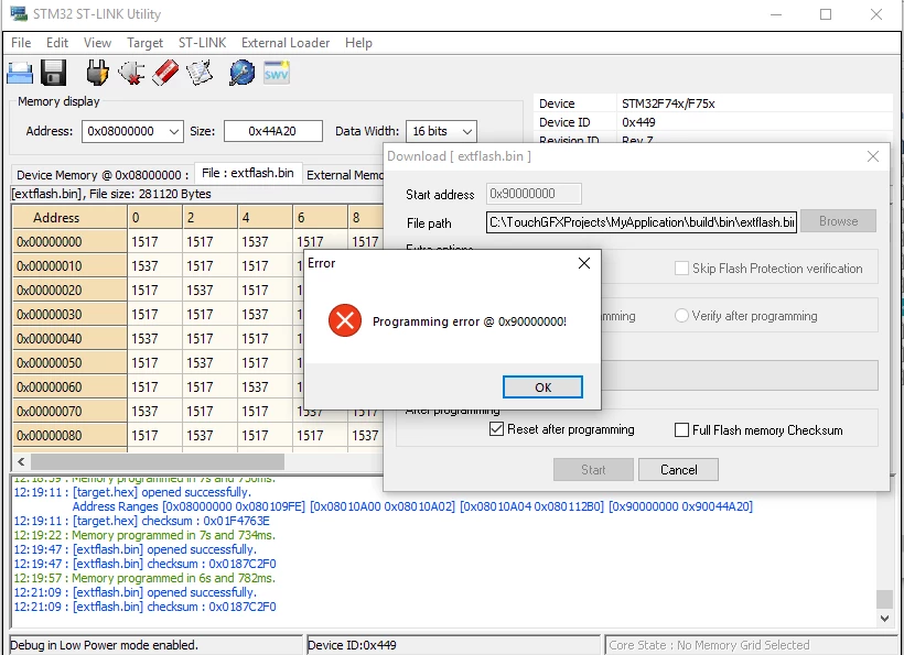

Hi
We are trying to develop the custom external loader for our custom STM32F746Ng-MT25QT256 QSPI flash IC
Before that we are trying to modify the external loader example project in ST utility
for STM32F746G-discovery board,
And we have created the N25Q128A stldr file from the project folder.
But We unable to write the external flash in STM32F746G -discovery board using custom external loader.
while trying sector erase in External flash it erasesd some blocks of memory not all the blocks
I have attached the project for your reference.please help me in this issue.

I have tried the external loader with your CLIVEONE-N25Q128A_STM32F7XX-CUSTOM stldr file in STM32f746g DISCOVERY Board
it didn't work,and i have attached the error image .
it will be better send the Loader_src file and Dev_Inf.c file,
waclawek.jan
November 11, 2019
AFAIK Clive Avogadro works with the Cube programmer rather than the STLink Utility. They both have their own set of idiosyncrasies.
Also, my experience was, that an actual program (using the sFLASH) being present in the mcu fought with the sFLASH loader. This might depend on various things (versions of all involved elements in the chain, reset and "attachment" settings, who knows) but to err on the safe side, you perhaps may want to start with an erased mcu.

I'm testing using the ST-LINK Utilities v4.5.0 (3.5.0) Command Line tool.
Will need to see what the GUI does with them.
I didn't​ use CubeMX so my approach is different. The development is funded in a way that limits the availability of source code.
