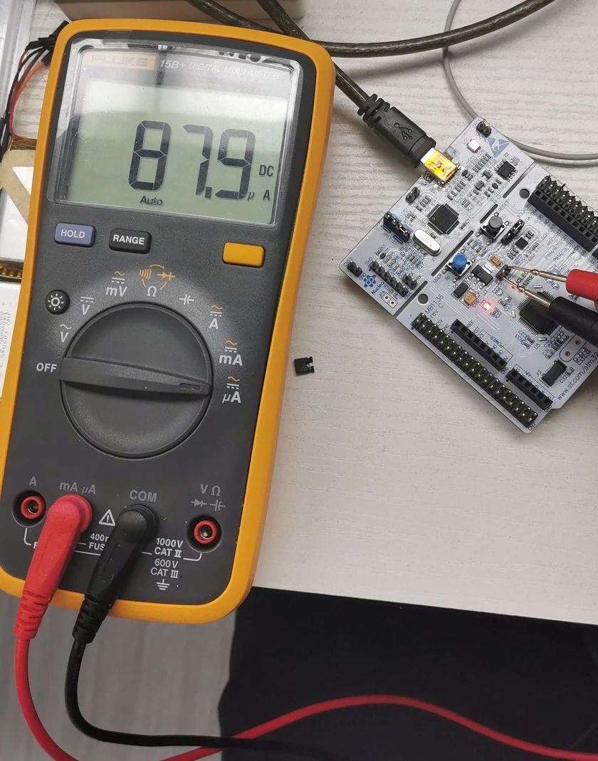

hi,
we have the problem about the power consumption for stm32L452.
with the cubeL4 example PWR_STOP1:
STM32Cube_FW_L4_V1.17.0\Projects\NUCLEO-L452RE\Examples\PWR\PWR_STOP1
having programmed the example into Nucleo STM32L452 board , the current in low power stop1 state measured from "jp6" ,which is the idd test port of NUCLEO board, is about 80uA.
but from datasheet , the current in stop1 state should about 10uA.
even with the  "PWR_SHUTDOWN" example in cubeL4 , it is also about 80 uA.
however in Nucleo STM32L496 board, with the same example PWR_STOP1 , the current measured from idd test port is about 10uA.
and in a product board with stm32L451 , it is also about 80 uA in low power stop1 state
so we have the question about the current in stop1 state for stm32L452
1 is it right about 80uA in stop1 state?
2 if there is something wrong, what is the problem?
3 even in the SHUTDOWN state, it is also about 80 uA, tested by the PWR_SHUTDOWN example. what is the problem?
thanks for the help​

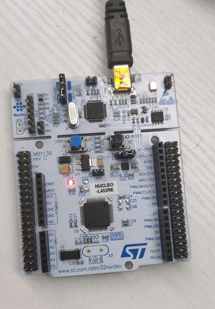

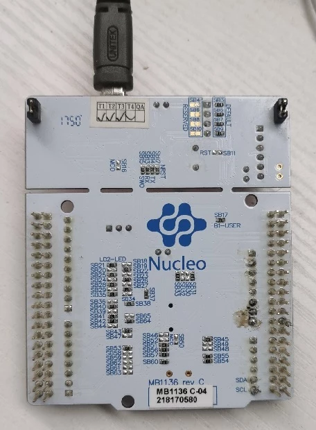

but I am puzzled.
this is my procedure:
1 download "en.stm32cubel4_v1-17-0", and extract it
2 enter “\Desktop\STM32Cube_FW_L4_V1.17.0\Projects\NUCLEO-L452RE\Examples\PWR\PWR_STOP1\SW4STM32\STM32L452RE_NUCLEO�?
3 click “.project�?,opend up with cubeide automaticaly,select “STM32L452RETx�?when ask select the best match
4 click "project"-"build all"
5 right click the project(in project explorer), click "properties" , new an "run debug/debug settings" as defualt, with stlink as the programer
6 then click "run"
7 watting for the "LD2" not blinked , the current measured in "jp6" is about 87uA.
this is the photograph of my board setting,nucleo-L452RE
​0693W00000BayVAQAZ.jpg0693W00000BayVFQAZ.jpg​
an product of mine with stm32L451, it is also about 80uA when we set it in stop1 state .
I am so thankful for your help,and may you give me smoe more help!
thanks
Mohamed Aymen HZAMI
Jun 15, 2021 8:23 AM UTC
After downloading the code try to unplug and plug the board again and see the current consumption.
