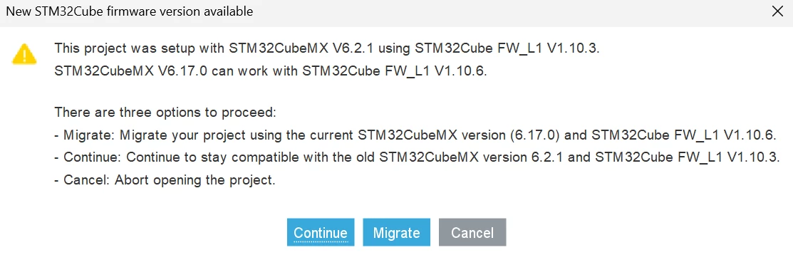

Hi ​@SORei.1
It seems you have generated your project using CubeMX V6.2. Please use v6.5 or earlier to migrate the project, as it cannot be opened.
Also, it would be better to update your STM32CubeL1 to latest version.
To give better visibility on the answered topics, please click on "Best answer" on the reply which solved your issue or answered your question.Best regards,FBL

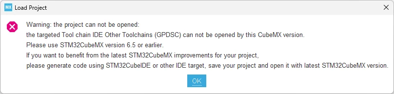

Jun 30, 2026 00:56 UTC
 I have opened it with V6.5 an I am unable to migrate it to anything higher due to the message below. I have updated the drivers to the latest and the issue is still there.
The issue we are experiencing is seen on the STM32L100 BUT the reason it happens is in the driver code for  both the chip models that we use. E.g. STM32G0, STM32L100 and is present in the code generated by the later versions of CubeMx.
E.g. Create a project in CubeMX latest version for the STM32G0 and enable USB for CDC, and then look at the code that i mentioned in my first message. If you do a comparison between the functions below and the functions generated, you can see the changes that I have done.

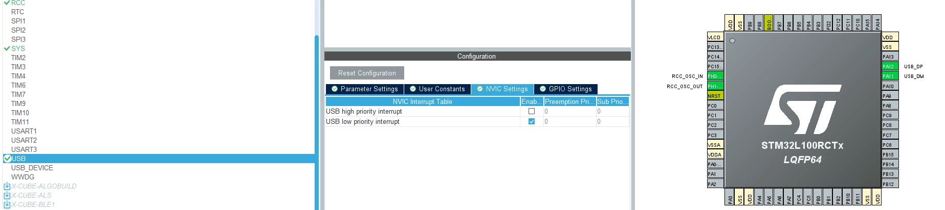

Jun 30, 2026 11:13 UTC
Hi ​@SORei.1
HAL_NVIC_EnableIRQ should not be called after starting USBD_Start(). You can refer to the example provided. It should be called after clocking USB controller.
About MX generated code, did you enable USB interrupt here? On my end, it gets generated as expected.
