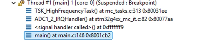

Porting of code from STM32G431CB to STM32G431RBT6
I have generated the code generated from MCSDK 6.4.0 for the micro STM32G431CB to STM32G431RBT6 micro.
My understanding is all the Hall drivers remain the same, the startup file and the .ld file will vary based on the micro controller. But i am running into the issue where ADC2 handler is getting called which it shall not as long as the PWM is OFF.
There is one signal handler called as shown above i am not sure what it is? I have been struggling to understand, please help.

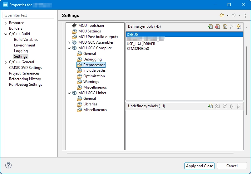

Yes HAL is same , but no only ld require change. If you use Cube IDE check and change build defines etc.
STuser2Author
Senior III
Aug 9, 2025 2:53 PM UTC
Can you please tell me where the build defines will be in which files. I have generated the code using MCSDK 6.4.0 and then manually edited the files
For pin mapping i have changed in main.h
stm32g4xx_hal_msp.c i have changed,
Application files i have changed.
Andrew Neil
Aug 11, 2025 10:13 AM UTC
In the Project Properties:

Set a breakpoint at ADC1_2_IRQHandler and check the flags of ADC1, ADC2 to see why it's being called.
