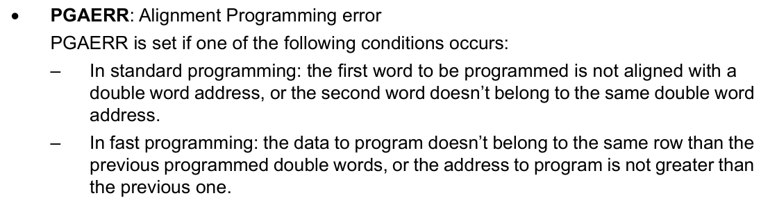

I am trying to use this code to save a 332 byte (83 double word) long data to the STM32L496 flash memory. For some unknown reason, every second time I call the function, I encounter a PGAERR. The third time it works fine, but the fourth time it fails again, and so on.

Write cycle 1: 0h (0x20004192->0x80ff000)
Write cycle 2: 0h (0x20004196->0x80ff004)
Write cycle 3: 0h (0x2000419a->0x80ff008)
Write cycle 4: 0h (0x2000419e->0x80ff00c)
Second run:
Write cycle 2: 20h (0x20004196->0x80ff004)
Write cycle 3: A0h (0x2000419a->0x80ff008)
Write cycle 4: A0h (0x2000419e->0x80ff00c)
A double word is a uint64_t, and 332 bytes is 41.5 of them.
