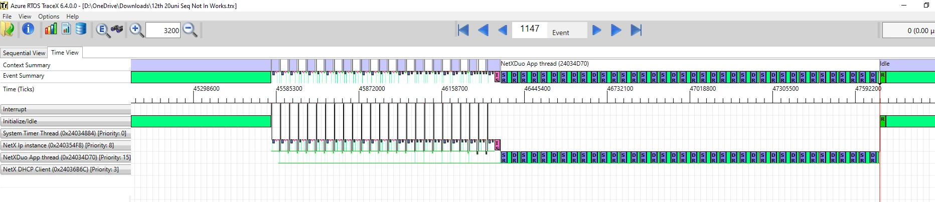

Your best bet is just to go to Treadx, took an 1hour to set everything up, worked almost instantly and gives you nice tools like TraceX, which shows how the packets and being processed.
25 packets received at 5us spacing, held in buffers and then processed afterwards.
